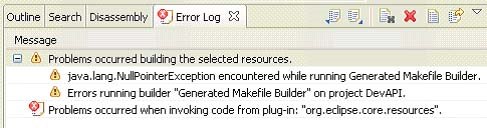

  1. Some projects of the workspace failed to compile with the --program_level_compile compiler flag. Compilation doesn`t start, CCS gives an error to the Error log:

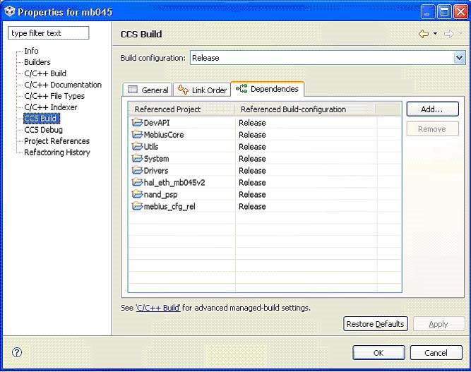

5. It seems that Referenced Build Configuration in the Dependences tab doesn`t work at all.
I configured it to build referenced projects with release profile in Release and with debug profile in debug, but that doesn`t work. Referenced projects compile with their current active configuration set in the C/C++ Projects tab.
6.  I want to use different RTSC configuration projects for Release and Debug build configurations.
How can I do this?
When I add both projects to referenced projects list with different build configurations it doesn`t work. Adding one for release and another for debug doesn`t work also (both of them added for both configurations).

  • Yuriy,
    Specifying specific configurations in the build dependencies does not work very well.  There is another thread that goes through this in more detail.  One workaround proposed is to create a little script.  There is an example in the thread.
    http://e2e.ti.com/support/development_tools/code_composer_studio/f/81/p/97474/347314.aspx#347314
