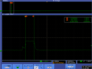

I am testing AM6442 in TMDS64EVM(PROC101C, HS-FS chip) with MCU+SDK 9.00.00.35 adc_singleshot_am64x-evm_r5fss0-0_nortos_ti-armclang example.
I had mesure the FIFO read time by edit sample as this,
    GPIO_pinWriteHigh(CSL_GPIO1_BASE, 66); // for debugg pad C18
  //  for (loopcnt = 0U; loopcnt < fifoWordCnt; loopcnt++)
     //  fifoData = ADCGetFIFOData(baseAddr, ADC_FIFO_NUM_0);
    fifoData = HW_RD_REG32(baseAddr + ADC_FIFODATA(ADC_FIFO_NUM_0));
    GPIO_pinWriteLow(CSL_GPIO1_BASE, 66); // for debugg Time count
In this code, ADC FIFO read time could mesure as GPIO HI time.
As a result, the time was about 400 ns.
I think the CPU is runnning 800 MHz, So we could more fast read.
Is there any way to more fast read the FIFO?
Or is this FIFO memory's max performance?

  • Hello GR ,
    I have looked at your code, and it seems fine.
    But in your test code, there is a for loop, GPIO_pinWriteHigh and GPIO_pinWriteLow functions creates a delay in your measurement.
    Even if we remove delays of GPIO_pinWriteHigh and GPIO_pinWriteLow functions, approximately you may have the same measurement.
    Yes, your understanding is correct. This time (400 ns) would be required to read FIFO data for all channels.
     May I know what your case is here to better assist you?

  • Hello Anil,
    Thanks for your information.
    This information is what I want to know.
    I understand.
