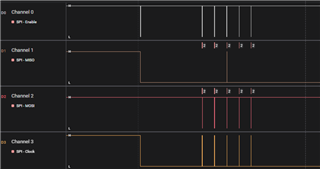

Hi TI support teams,
I'm now implementing a Linux Driver to control an IC which is using SPI as communication channel and have some issue.
Please help check.
My devicetree will define the pin like these:

And here is my driver that using the spi_write/spi_read to wirte/read via SPI:

I've captured the SPI data like below. I use logic analyzer to capture it.
Here you can see the SCK, MOSI and MISO.
The SCK and MOSI seems normal, but I don't see any value on the MISO line.
Could you please take a look about that. I'm not sure what I'm missing here.
Loc.
