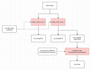

I was previously using Nearest neighbor with coefficient to resize MSC.
However, to use DOF, I found that I need to use a pyramid coefficient to make it work properly (TIVX_VPAC_MSC_CMD_SET_COEFF).
If I use TIVX_VPAC_MSC_CMD_SET_COEFF to set the coefficient of the MSC to use DOF, the problem occurs because the MSC does not use the nearest neighbor when resizing.
Is there a good way to solve this situation?
best regards.

  • Hi Brijesh,
    In the existing MSC, multi_phase of tivx_vpac_msc_coefficients_t struct variable was set to NN resizer coefficient.
    However, in order to use DOF normally, I had to set the pyramid coefficient in pyramid_node to TIVX_VPAC_MSC_CMD_SET_COEFF to check the normal behavior.
    Since I use both MSC and DOF, when I set TIVX_VPAC_MSC_CMD_SET_COEFF for DOF, the multi_phase of tivx_vpac_msc_coefficients_t struct variable is changing the NN resizer coefficient in the existing MSC.
    Let me know if you need more information.
    Hyeonseong
  • Hi Hyeonseong,
    ok, as i understand, you are MSC at two places, one for generating pyramid for DOF processing and the other for scaling operation. For the scaling operation, you require NN coefficients, but pyramid generation, you require different coefficients. Please confirm if this is correct understanding.
    Yes, this is possible. Scalar supports multiple sets of coefficients and for each scaling operation, we can select the coefficients. so you can configure coefficients set 0 to NN coefficients and probably set1 for the other coefficients and then scalar can choose set0 or set1 coefficients.
    Brijesh
  • Hi Brijesh,
    You are correct in your understanding.
    You said you can set0, set1 the coefficient of the scaler, can you give me a code example of how to do that?
    Hyeonseong

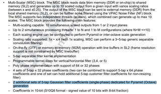

    As we can see in below structure, there are multiple sets of coefficients that we can set using the same control command
    typedef struct {
    /*! 2 Sets of Single phase coefficient set 0, signed 10-bit */
    int32_t single_phase[TIVX_VPAC_MSC_MAX_SP_COEFF_SET][TIVX_VPAC_MSC_MAX_TAP];
    /*! 4 Sets of Multi phase coefficient, signed 10-bit */
    int32_t multi_phase[TIVX_VPAC_MSC_MAX_MP_COEFF_SET]
    [TIVX_VPAC_MSC_MAX_TAP*TIVX_VPAC_MSC_32_PHASE_COEFF];
    } tivx_vpac_msc_coefficients_t;
    and then depending on the phase mode, we can select one of the scaling coefficients in the phase_params_t structure, as highlighted below.

    As shown in the attached image, I want to use nn resizer coefficient for scaler node 0,1 and pyramid node for pyramid coefficient.
    And currently, to set the pyramid coefficient to the pyramid node, I am using tivxNodeSendCommand in the prologue of ovx graph.
    For our use case, we are using it like this. Is it possible to solve it in our usecase with the multiple sets of coefficients method you mentioned?
    If it can be solved, how should we configure it with tivx_vpac_msc_multi_phase_params_t to solve it? I've looked through the TI sample code but didn't find any code that uses tivx_vpac_msc_multi_phase_params_t.
    Currently we are using tivx_vpac_msc_coefficients_t to control the msc.
    Hyeonseong
  • Hi Hyeonseong,
    As i said, you can set the two sets of the scaling coefficients either in core0, core1 or in pyramid node. or you can set same set coefficients sets in all of them and then change the scaling parameters to use appropriate set in each node. This is possible and supported in the SDK.
    Brijesh

            output_params[0].multi_phase.init_phase_x = TIVX_VPAC_MSC_AUTOCOMPUTE;
            output_params[0].multi_phase.init_phase_y = TIVX_VPAC_MSC_AUTOCOMPUTE;
    The error command occurs when calling
    status = tivxNodeSendCommand(pyramid_node_, 0u, TIVX_VPAC_MSC_CMD_SET_OUTPUT_PARAMS, output_refs, 5u);.
    Hyeonseong
  • In addition
    Can Gaussian Filter for Pyramid only be used for single phase filters?
    2 additional sets of 5-tap Gaussian filter coefficients (single-phase) dedicated for Pyramid (Octave) generation. Do I need to use both set0 and set1 to do Pyramid generation?
    Or is it still possible to use NN resizer for set0 and Gaussian filter for set1 which is what I want to use?
    Well, i dont know the exact coefficients to be used in this case, but i guess you can use it.

  • Hi Brijesh,
    What does an MSC instance mean? Will the code below help?
            pyramid_node_ = tivxVpacMscPyramidNode(graph, input_image_, pyramid_reference_);
            status = vxGetStatus((vx_reference)pyramid_node_);
            if (status != VX_SUCCESS) {
                return status;
            status |= vxSetNodeTarget(pyramid_node_, VX_TARGET_STRING, TIVX_TARGET_VPAC_MSC2);
            status |= vxSetReferenceName((vx_reference)pyramid_node_, "pyramid_node");
    Additionally, it seems to work for the set0, set1 settings of the output param in the MSC node.
    However, when I applied it in the same way on a pyramid node, I found that it didn't work.
    Hyeonseong

    [MCU2_0]   1431.383436 s:  VX_ZONE_ERROR:[tivxVpacMscPmdProcess:1110] #######################################
    [MCU2_0]   1431.383509 s:  VX_ZONE_ERROR:[tivxVpacMscPmdProcess:1111] (0x0F000000 + 0x1c0010 + 0x120) = 0x201088
    [MCU2_0]   1431.383584 s:  VX_ZONE_ERROR:[tivxVpacMscPmdProcess:1112] (0x0F000000 + 0x1c0010 + 0x124) = 0x0
    [MCU2_0]   1431.383671 s:  VX_ZONE_ERROR:[tivxVpacMscPmdProcess:1113] (0x0F000000 + 0x1c0010 + 0x128) = 0x8000f0
    [MCU2_0]   1431.383743 s:  VX_ZONE_ERROR:[tivxVpacMscPmdProcess:1114] (0x0F000000 + 0x1c0010 + 0x12C) = 0x20002000
    [MCU2_0]   1431.383799 s:  VX_ZONE_ERROR:[tivxVpacMscPmdProcess:1115] (0x0F000000 + 0x1c0010 + 0x130) = 0x8000800
    [MCU2_0]   1431.383850 s:  VX_ZONE_ERROR:[tivxVpacMscPmdProcess:1128] #######################################
    [MCU2_0]   1431.432400 s:  VX_ZONE_ERROR:[tivxVpacMscScaleProcess:838] Failed to Get Processed Request
    [MCU2_0]   1431.434549 s:  VX_ZONE_ERROR:[tivxVpacMscPmdProcess:1110]
    When I also commented out the Vhwa_m2mMscSubmitRequest, the pipeline doesn't seem to create. It runs for 1 frame and then stops.
    Additionally, I call tivxNodeSendCommand with TIVX_VPAC_MSC_CMD_SET_CROP_PARAMS every frame in the pipeline, could this be a problem?
    Hyeonseong

  • Hi Brijesh
    When you say both nodes, do you mean running on TIVX_TARGET_VPAC_MSC1 or TIVX_TARGET_VPAC_MSC2 for testing?
    If what I'm saying is correct, both MSC1 and MSC2 are not producing normal results.
    output  of TIVX_TARGET_VPAC_MSC1
    - The resulting image is not generated properly.
    [MCU2_0]   3641.619594 s:  VX_ZONE_ERROR:[tivxVpacMscPmdProcess:1110] #######################################
    [MCU2_0]   3641.619710 s:  VX_ZONE_ERROR:[tivxVpacMscPmdProcess:1111] (0x0F000000 + 0x1c0010 + 0x120) = 0x220003
    [MCU2_0]   3641.619780 s:  VX_ZONE_ERROR:[tivxVpacMscPmdProcess:1112] (0x0F000000 + 0x1c0010 + 0x124) = 0xc60240
    [MCU2_0]   3641.619849 s:  VX_ZONE_ERROR:[tivxVpacMscPmdProcess:1113] (0x0F000000 + 0x1c0010 + 0x128) = 0x600200
    [MCU2_0]   3641.619907 s:  VX_ZONE_ERROR:[tivxVpacMscPmdProcess:1114] (0x0F000000 + 0x1c0010 + 0x12C) = 0x18001800
    [MCU2_0]   3641.619963 s:  VX_ZONE_ERROR:[tivxVpacMscPmdProcess:1115] (0x0F000000 + 0x1c0010 + 0x130) = 0x4000400
    [MCU2_0]   3641.620018 s:  VX_ZONE_ERROR:[tivxVpacMscPmdProcess:1117] (0x0F000000 + 0x1c0010 + 0x00) = 0x201088
    [MCU2_0]   3641.620073 s:  VX_ZONE_ERROR:[tivxVpacMscPmdProcess:1118] (0x0F000000 + 0x1c0010 + 0x04) = 0x0
    [MCU2_0]   3641.620128 s:  VX_ZONE_ERROR:[tivxVpacMscPmdProcess:1119] (0x0F000000 + 0x1c0010 + 0x08) = 0x8000f0
    [MCU2_0]   3641.620189 s:  VX_ZONE_ERROR:[tivxVpacMscPmdProcess:1120] (0x0F000000 + 0x1c0010 + 0x0C) = 0x20002000
    [MCU2_0]   3641.620247 s:  VX_ZONE_ERROR:[tivxVpacMscPmdProcess:1121] (0x0F000000 + 0x1c0010 + 0x10) = 0x8000800
    [MCU2_0]   3641.620302 s:  VX_ZONE_ERROR:[tivxVpacMscPmdProcess:1128] #######################################
    output  of TIVX_TARGET_VPAC_MSC2
    - Image color conversion is not working correctly.
    [MCU2_0]   4076.218090 s:  VX_ZONE_ERROR:[tivxVpacMscPmdProcess:1111] (0x0F000000 + 0x1c0010 + 0x120) = 0x201088
    [MCU2_0]   4076.218164 s:  VX_ZONE_ERROR:[tivxVpacMscPmdProcess:1112] (0x0F000000 + 0x1c0010 + 0x124) = 0x0
    [MCU2_0]   4076.218250 s:  VX_ZONE_ERROR:[tivxVpacMscPmdProcess:1113] (0x0F000000 + 0x1c0010 + 0x128) = 0x8000f0
    [MCU2_0]   4076.218323 s:  VX_ZONE_ERROR:[tivxVpacMscPmdProcess:1114] (0x0F000000 + 0x1c0010 + 0x12C) = 0x20002000
    [MCU2_0]   4076.218397 s:  VX_ZONE_ERROR:[tivxVpacMscPmdProcess:1115] (0x0F000000 + 0x1c0010 + 0x130) = 0x8000800
    [MCU2_0]   4076.218453 s:  VX_ZONE_ERROR:[tivxVpacMscPmdProcess:1117] (0x0F000000 + 0x1c0010 + 0x00) = 0x220003
    [MCU2_0]   4076.218508 s:  VX_ZONE_ERROR:[tivxVpacMscPmdProcess:1118] (0x0F000000 + 0x1c0010 + 0x04) = 0x0
    [MCU2_0]   4076.218562 s:  VX_ZONE_ERROR:[tivxVpacMscPmdProcess:1119] (0x0F000000 + 0x1c0010 + 0x08) = 0x1000380
    [MCU2_0]   4076.218621 s:  VX_ZONE_ERROR:[tivxVpacMscPmdProcess:1120] (0x0F000000 + 0x1c0010 + 0x0C) = 0x21c02249
    [MCU2_0]   4076.218679 s:  VX_ZONE_ERROR:[tivxVpacMscPmdProcess:1121] (0x0F000000 + 0x1c0010 + 0x10) = 0x8e00925
    Hyeonseong
  • Hi Hyeonseong,
    Brijesh is currently out of office, and will follow-up once he is back in office later this week.
    regards
    Suman
  • Hyeonseong,
    Sorry for the late reply.
    When you say, not producing correct result, do you mean the error "Failed to get prcessedRequest"? or you dont see correct output due to coefficient?
    Also when you use MSC1, please refer to below registers
    according to above registers
    - you are using single phase coefficients for both horizontal and vertical scaling.
    - for horizontal scaling you are using coefficient set 0
    - for vertical scaling, you are using coefficient set 1
    and when you use MSC2, please refer to below registers
    It looks like you are still using single phase coefficients only for the both the above cases. Can you please change it to use multi-phase coefficients?
    Brijesh

    23461.345131 s:  VX_ZONE_ERROR:[send_command:1042] out_param->multi_phase.vert_coef_sel = 2
    23461.345136 s:  VX_ZONE_ERROR:[send_command:1043] out_param->multi_phase.init_phase_x = 0
    23461.345142 s:  VX_ZONE_ERROR:[send_command:1044] out_param->multi_phase.init_phase_y = 0
    -> tivxNodeSendCommand(pyramid_node_, 0u, TIVX_VPAC_MSC_CMD_SET_OUTPUT_PARAMS, output_refs_, 4u) prints output_refs before the function.

    -> Print sc_cfg after tivxVpacMscPmdCopyOutPrmsToScCfg call in tivxVpacMscPmdSetOutputParamsCmd()
    However, the "Failed to Get processed Request" error still occurs, and the value of the MSC register does not change to the desired value.

    Hyeonseong
  • Hi Hyeonseong,
    This is strange, Is it possible to share this example to check it on EVM? I want to try it out on EVM and see why registers are not getting updated? or any other example i can use to reproduce this on EVM?
    Brijesh
  • Hi
    Should I provide an ovx graph example code with msc code that reproduces the above issue? Or can you tell me what form of code you'd like to receive?

  • Hi Hyeonseong,
    I think i know why we are not seeing correct registers and why it is using single phase coefficients only for pyramid node.
    In this API tivxVpacMscPmdSetOutputParamsCmd, in the file ti-processor-sdk-rtos-j721e-evm-08_06_00_12\tiovx\kernels_j7\hwa\vpac_msc\vx_vpac_msc_pyramid_target.c, can you please make below small change, rebuild SDK and then try out?
    Change from
            else
                VX_PRINT(VX_ZONE_ERROR, "Null User Data Object\n");
                status = (vx_status)VX_ERROR_INVALID_PARAMETERS;
            if ((vx_status)VX_SUCCESS == status)
                break;
    to
            else
            if ((vx_status)VX_SUCCESS != status)
                break;
    There was a typo in error checking, because of which, the multi-phase coefficients was set only for the first pyramid level and rest all were still using single phase. With the above change, you should see all levels using multi-phase coefficients.
    Brijesh

    For ss_idx = 0 sc_idx = 8 / ss_idx = 1 sc_idx = 9 / ss_idx = 1 sc_idx = 8, filterMode, phaseMode, hsMpCoeffSel, vsMpCoeffSel are not applied as multi phase. Could this be the problem? Perhaps all levels of pyramid level 4 are not set to multi phase.

    Here is the code to generate and set the DOF, let me know if you need anything else.
    oz_vx_svnet3_ffc_post_process_node_agent.cpp
    - oz_vx_svnet3_ffc_post_process_node_agent.hpp

    Call set_msc_node_params() in the prologue function of the pipeline graph.
    vx_status SVOzVxGraphFfcVt::set_msc_node_params()
        vx_status status = VX_SUCCESS;
        uint32_t num_of_core = 0;
        for (num_of_core = 0; num_of_core < max_num_of_msc_core_; ++num_of_core) {
            status = msc_node_agent_[num_of_core].send_command(TIVX_VPAC_MSC_CMD_SET_COEFF);
            APP_ASSERT(status == VX_SUCCESS);
            msc_node_agent_[num_of_core].send_command(TIVX_VPAC_MSC_CMD_SET_CROP_PARAMS);
        if (en_opfe_dof_ == kEnTrue) {
            status = sv_post_node_agent_.send_command(OzVxSvnet3FfcPostProcessNodeAgent::kSetMSCCoeff);
            // printf("msc_node_agent_[0].send_command(TIVX_VPAC_MSC_CMD_SET_OUTPUT_PARAMS)\n");
            // status = msc_node_agent_[0].send_command(TIVX_VPAC_MSC_CMD_SET_OUTPUT_PARAMS);
            // printf("msc_node_agent_[1].send_command(TIVX_VPAC_MSC_CMD_SET_OUTPUT_PARAMS)\n");
            // status = msc_node_agent_[1].send_command(TIVX_VPAC_MSC_CMD_SET_OUTPUT_PARAMS);
            printf("sv_post_node_agent_.send_command(OzVxSvnet3FfcPostProcessNodeAgent::kSetMSCOutputParam)\n");
            status = sv_post_node_agent_.send_command(OzVxSvnet3FfcPostProcessNodeAgent::kSetMSCOutputParam);
        return status;
    Hyeonseong

    Q) After all, how should I configure tivx_vpac_msc_output_params_t output_params if I want set0 to use an NN resizer and set1 to use a Gaussian Filter?
    Below are the parameter values I am using.
    In MSC
            tivx_vpac_msc_output_params_t output_params[5];
            tivx_vpac_msc_output_params_init(&output_params[0]);
            output_params[0].signed_data = 1;
            output_params[0].filter_mode = 1; // Multi-phase scaling
            output_params[0].coef_shift = 8;
            output_params[0].saturation_mode = 0;
            output_params[0].offset_x = TIVX_VPAC_MSC_AUTOCOMPUTE;
            output_params[0].offset_y = TIVX_VPAC_MSC_AUTOCOMPUTE;
            output_params[0].output_align_12bit = 0;
            output_params[0].multi_phase.phase_mode = 1;
            output_params[0].multi_phase.horz_coef_sel = 0;
            output_params[0].multi_phase.vert_coef_sel = 0;
    In Pyramid
            output_params[0].signed_data = 0;
            output_params[0].offset_x = 0;
            output_params[0].offset_y = 0;
            output_params[0].multi_phase.horz_coef_sel = 2;
            output_params[0].multi_phase.vert_coef_sel = 2;
            output_params[0].multi_phase.init_phase_x = 0;
            output_params[0].multi_phase.init_phase_y = 0;
    Hyeonseong
