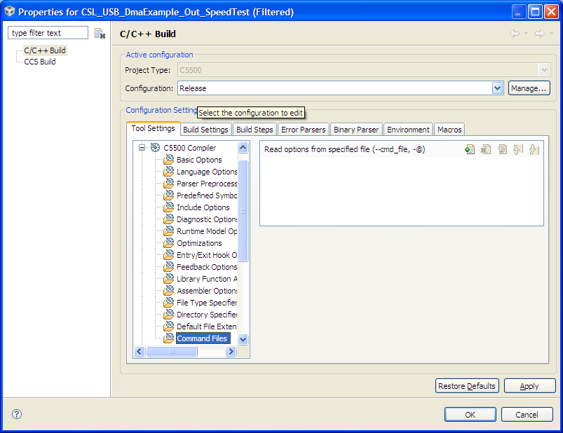

VC5505 EVM USB example error.
Other Parts Discussed in Thread: TMS320VC5505
I was running the CSL_USB_DmaExample_Out.c file and got the following error when I tried to run "Check streaming WRITE speed" option on the C5505_USB_Host_Tool.
Read/Write from/to device's pipes using Streaming Data Transfers
1.  Read from pipe
2.  Write to pipe
3.  Listen to pipe (continuous read)
4.  Check streaming READ speed
5.  Check streaming WRITE speed
6.  Switch to Single Blocking Transfers mode
99. Main menu
Enter option: 5
Please enter the pipe number (hex): 0x02
The size of the buffer to transfer(dec): 10240
The size of the internal Rx/Tx stream buffer (dec): 5120000
Making the transfer of 15000 times the buffer size, please wait ...
ReadWritePipesMenu: Transfer failed: error 0x20000020 ("Operation failed")
Please advise.
Ajay.
  • Ajay,
    Using which CSL version?
    http://focus.ti.com/docs/toolsw/folders/print/sprc133.html
    Are you using the TMS320VC5505 EVM?
    Mark
    I am using the TMS320VC5505 and the C55XCSL-LowPower ver 2.50.00.00.
    Ajay
  • Hi Ajay,
    Did you remember to uncomment the VC5505 definition in csl_general.h?
    /* TMS320VC5505 */
    //#define CHIP_VC5505
    Try the attached csl_usb_dma_example.c and VC5505_USB.cmd files with the CSL 2.50 CSL_USB_DmaExample project.

  • Hi Ajay,
    That error must mean that you have defined a linker .cmd file in the Build Properties that cannot be found.
    Try deleting all entries in the Command Files section of the C5500 Compiler settings:
    Right click on CSL_USB_DmaExample_Out --> Click on Build Properties --> Click on Command Files (Under C5500 Compiler) --> Delete every line under "Read options from specified file (--cmd_file, -@)
    You should still see your VC5505_USB.cmd file with the other project files when CSL_USB_DmaExample_Out is expanded from the View --> C/C++ Projects window.
    If you see two .cmd files, right click on one of them and check the "Exclude File(s) from Build" option.
    Hope this helps,
    Mark
  • Hi Mark,
    You were right I had defined a linker .cmd file in the build properties.
    The project builds properly now and I was able to run the 'Check streaming Read speed' and 'Check Streaming Write Speed' tests successfully.
