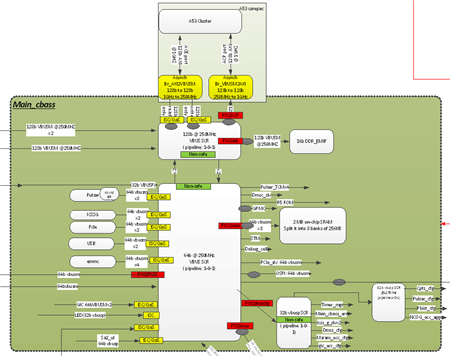

  • Adding a further detail here. The TRM does not have the detailed topology, instead just a simplified "CBASS0" for all of the interconnect. This is the more exact way the interconnect is done, A53 to LPDDR4/DDR4 on one block, then the rest of the main initiators on another.
