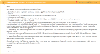

  • Hi Andrew,
    I am routing your query to our DSS expert for comments.
    I would reocmmend you to review the following thread: https://e2e.ti.com/support/processors-group/processors/f/processors-forum/1011994/am3358-updating-splash-screen-progress-bar-in-am3358/3864676#3864676. There is splash driver that the community wrote for Yocto and you may need to port that to Debian.
    Krunal

  • Hi Krunal,
    1.Below is the result after I tried using the method in this thread:(step1~step6)
    andrew@andrew-GENESYS-CML5:~/project/ti_e2e_test$ ls -al
    total 8
    drwxrwxrwx  2 andrew andrew 4096 10月 18 16:54 .
    drwxrwxrwx 18 andrew andrew 4096 10月 18 11:44 ..
    andrew@andrew-GENESYS-CML5:~/project/ti_e2e_test$ git clone git://git.openembedded.org/bitbake ./bitbake
    Cloning into './bitbake'...
    remote: Enumerating objects: 63464, done.
    remote: Counting objects: 100% (174/174), done.
    remote: Compressing objects: 100% (171/171), done.
    remote: Total 63464 (delta 81), reused 0 (delta 0), pack-reused 63290
    Receiving objects: 100% (63464/63464), 13.60 MiB | 697.00 KiB/s, done.
    Resolving deltas: 100% (47466/47466), done.
    total 12
    drwxrwxrwx  3 andrew andrew 4096 10月 18 17:11 .
    drwxrwxr-x  9 andrew andrew 4096 10月 18 17:11 bitbake
    andrew@andrew-GENESYS-CML5:~/project/ti_e2e_test$ export PATH=/home/andrew/project/ti_e2e_test/bitbake/bin:$PATH
    andrew@andrew-GENESYS-CML5:~/project/ti_e2e_test$ export PYTHONPATH=/home/andrew/project/ti_e2e_test/bitbake/lib:$PYTHONPATH
    andrew@andrew-GENESYS-CML5:~/project/ti_e2e_test$ git clone git://arago-project.org/git/projects/oe-layersetup.git tisdk
    Cloning into 'tisdk'...
    fatal: unable to connect to arago-project.org:
    arago-project.org[0: 192.163.14.205]: errno=Connection timed out
    andrew@andrew-GENESYS-CML5:~/project/ti_e2e_test$ git clone https://github.com/adannenb-ti/oe-layersetup.git tisdk
    remote: Enumerating objects: 2146, done.
    remote: Counting objects: 100% (2146/2146), done.
    remote: Compressing objects: 100% (494/494), done.
    remote: Total 2146 (delta 1653), reused 2135 (delta 1642), pack-reused 0
    Receiving objects: 100% (2146/2146), 266.94 KiB | 1.66 MiB/s, done.
    Resolving deltas: 100% (1653/1653), done.
    total 16
    drwxrwxrwx  4 andrew andrew 4096 10月 18 17:15 .
    drwxrwxr-x  5 andrew andrew 4096 10月 18 17:15 tisdk
    andrew@andrew-GENESYS-CML5:~/project/ti_e2e_test$ cd tisdk/
    andrew@andrew-GENESYS-CML5:~/project/ti_e2e_test/tisdk$
    andrew@andrew-GENESYS-CML5:~/project/ti_e2e_test/tisdk$ ./oe-layertool-setup.sh -f configs/arago-dunfell-config.txt
    /home/andrew/project/ti_e2e_test/tisdk
    cloning repo bitbake
    Cloning into '/home/andrew/project/ti_e2e_test/tisdk/sources/bitbake'...
    Receiving objects: 100% (63464/63464), 13.60 MiB | 861.00 KiB/s, done.
    Branch '1.46' set up to track remote branch '1.46' from 'origin'.
    Switched to a new branch '1.46'
    Already up to date.
    cloning repo meta-arago
    Cloning into '/home/andrew/project/ti_e2e_test/tisdk/sources/meta-arago'...
    remote: Enumerating objects: 44337, done.
    remote: Counting objects: 100% (856/856), done.
    remote: Compressing objects: 100% (202/202), done.
    remote: Total 44337 (delta 765), reused 659 (delta 648), pack-reused 43481
    Receiving objects: 100% (44337/44337), 13.47 MiB | 670.00 KiB/s, done.
    Resolving deltas: 100% (30887/30887), done.
    Branch 'dunfell' set up to track remote branch 'dunfell' from 'origin'.
    Switched to a new branch 'dunfell'
    Already up to date.
    cloning repo meta-qt5
    Cloning into '/home/andrew/project/ti_e2e_test/tisdk/sources/meta-qt5'...
    remote: Enumerating objects: 16380, done.
    remote: Counting objects: 100% (625/625), done.
    remote: Compressing objects: 100% (287/287), done.
    remote: Total 16380 (delta 357), reused 542 (delta 337), pack-reused 15755
    Receiving objects: 100% (16380/16380), 4.17 MiB | 11.42 MiB/s, done.
    Resolving deltas: 100% (11642/11642), done.
    Already up to date.
    cloning repo meta-virtualization
    Cloning into '/home/andrew/project/ti_e2e_test/tisdk/sources/meta-virtualization'...
    remote: Enumerating objects: 16400, done.
    remote: Total 16400 (delta 0), reused 0 (delta 0), pack-reused 16400
    Receiving objects: 100% (16400/16400), 4.47 MiB | 263.00 KiB/s, done.
    Resolving deltas: 100% (10140/10140), done.
    Already up to date.
    cloning repo meta-openembedded
    Cloning into '/home/andrew/project/ti_e2e_test/tisdk/sources/meta-openembedded'...
    remote: Enumerating objects: 221299, done.
    remote: Counting objects: 100% (67/67), done.
    remote: Compressing objects: 100% (60/60), done.
    remote: Total 221299 (delta 18), reused 1 (delta 1), pack-reused 221232
    Receiving objects: 100% (221299/221299), 55.36 MiB | 788.00 KiB/s, done.
    Resolving deltas: 100% (134576/134576), done.
    Already up to date.
    cloning repo meta-ti
    Cloning into '/home/andrew/project/ti_e2e_test/tisdk/sources/meta-ti'...
    remote: Enumerating objects: 47246, done.
    remote: Total 47246 (delta 0), reused 0 (delta 0), pack-reused 47246
    Receiving objects: 100% (47246/47246), 10.72 MiB | 535.00 KiB/s, done.
    Resolving deltas: 100% (32986/32986), done.
    Already up to date.
    cloning repo meta-arm
    Cloning into '/home/andrew/project/ti_e2e_test/tisdk/sources/meta-arm'...
    remote: Enumerating objects: 21729, done.
    remote: Total 21729 (delta 0), reused 0 (delta 0), pack-reused 21729
    Receiving objects: 100% (21729/21729), 5.26 MiB | 911.00 KiB/s, done.
    Resolving deltas: 100% (13942/13942), done.
    Already up to date.
    Note: checking out 'c4f04f3fb66f8f4365b08b553af8206372e90a63'.
    You are in 'detached HEAD' state. You can look around, make experimental
    changes and commit them, and you can discard any commits you make in this
    state without impacting any branches by performing another checkout.
    If you want to create a new branch to retain commits you create, you may
    do so (now or later) by using -b with the checkout command again. Example:
      git checkout -b <new-branch-name>
    HEAD is now at c4f04f3f arm/trusted-firmware-a: add branch name for mbedtls
    cloning repo oe-core
    Cloning into '/home/andrew/project/ti_e2e_test/tisdk/sources/oe-core'...
    remote: Enumerating objects: 502686, done.
    remote: Counting objects: 100% (3817/3817), done.
    remote: Compressing objects: 100% (1438/1438), done.
    remote: Total 502686 (delta 3080), reused 2691 (delta 2371), pack-reused 498869
    Receiving objects: 100% (502686/502686), 145.86 MiB | 1.24 MiB/s, done.
    Resolving deltas: 100% (359216/359216), done.
    Already up to date.
    The bblayers.conf configuration file has been created for you with some
    default values.  Please verify the contents of your conf/bblayers.conf
    file for correctness.
    NOTE: Any additional entries to this file will be lost if the ./oe-layertool-setup.sh
          script is run again.  To add entries permanently to this file
          please add them to the config file used and rerun the
          ./oe-layertool-setup.sh script.
    The local.conf configuration file has been created for you with some
    default values.  Please verify the contents of your conf/local.conf
    By default the number of threads used by the build is set to the number
    of CPUs found on your system.
    NOTE: You will probably want to change the default MACHINE setting in the
          local.conf file to the machine you are trying to build.
    A setenv file has been created for you in the conf directory.  Please verify
    The contents of this file.  Once you have verified the contents please source
    this file to configure your environment for building:
        . conf/setenv
    You can then start building using the bitbake command.  You will likely want
    to set the MACHINE option if you have not done so in your local.conf file.
    For example:
        MACHINE=xxxxx bitbake <target>
    Common targets are:
    From oe-core:
        core-image-tiny-initramfs: No Summary available
        core-image-minimal-dev: No Summary available
        core-image-minimal-mtdutils: No Summary available
        core-image-minimal:  A small image just capable of allowing a device to boot.
        build-appliance-image_15.0.0:  An image containing the build system itself
        core-image-minimal-initramfs: No Summary available
        core-image-base:  A console-only image that fully supports the target device \
    From meta-openembedded:
        meta-initramfs-image:  meta-initramfs build test image
        initramfs-kexecboot-klibc-image:  Initramfs image for kexecboot kernel (klibc-static binaries)
        initramfs-kexecboot-image:  Initramfs image for kexecboot kernel
        initramfs-debug-image: No Summary available
        meta-python-image-base:  meta-python build test image
        meta-python-image:  meta-python build test image
        meta-python-ptest-image:  meta-python ptest test image
        core-image-minimal-xfce: No Summary available
        meta-networking-image-base:  meta-networking build test image
        meta-networking-image: No Summary available
        meta-webserver-image: No Summary available
        meta-webserver-image-base:  meta-webserver build test image
        meta-oe-ptest-image:  meta-oe ptest test image
        meta-oe-image-base:  meta-oe build test image
        meta-oe-image:  meta-oe build test image
    From meta-arm:
        arm-autonomy-host-image-minimal: No Summary available
    From meta-arago[recommended]:
        tisdk-bootstrap-base-image:  Arago TI SDK bootstrap base image for initramfs
        tisdk-core-bundle:  Installer package for TI SDK - NOT for direct use on target
        tisdk-tiny-image:  Arago TI SDK super minimal base image for initramfs
        tisdk-thinlinux-image:  Arago TI SDK Thin Linux image
        tisdk-base-image:   Arago TI SDK base image with test tools
        tisdk-default-image:  Arago TI SDK full filesystem image
        tisdk-bootstrap-image:  Arago TI SDK bootstrap image usable for board bringup
    andrew@andrew-GENESYS-CML5:~/project/ti_e2e_test/tisdk$ cd build/
    andrew@andrew-GENESYS-CML5:~/project/ti_e2e_test/tisdk/build$ . conf/setenv
    andrew@andrew-GENESYS-CML5:~/project/ti_e2e_test/tisdk/build$ export TOOLCHAIN_PATH_ARMV7=$HOME/gcc-arm-9.2-2019.12-x86_64-arm-none-linux-gnueabihf
    andrew@andrew-GENESYS-CML5:~/project/ti_e2e_test/tisdk/build$ MACHINE=am62xx-evm bitbake psplash
    ERROR: Unable to start bitbake server (None)
    ERROR: Server log for this session (/home/andrew/project/ti_e2e_test/tisdk/build/bitbake-cookerdaemon.log):
    --- Starting bitbake server pid 3274 at 2023-10-18 17:28:06.899249 ---
    ERROR: Failed to obtain external Arm toolchain version: Execution of '/opt/gcc-arm-9.2-2019.12-x86_64-aarch64-none-linux-gnu/bin/aarch64-none-linux-gnu-gcc -v' failed: command not found
    ERROR: Error: EXTERNAL_TOOLCHAIN path '/opt/gcc-arm-9.2-2019.12-x86_64-aarch64-none-linux-gnu' does not exist
    andrew@andrew-GENESYS-CML5:~/project/ti_e2e_test/tisdk/build$ export TOOLCHAIN_PATH_ARMV7=/home/andrew/cross_compiler/gcc-arm-10.3-2021.07-x86_64-arm-none-linux-gnueabihf
    ERROR: Unable to find conf/bblayers.conf or conf/bitbake.conf. BBPATH is unset and/or not in a build directory?
    andrew@andrew-GENESYS-CML5:~/project/ti_e2e_test/tisdk/build$ export BBPATH=/home/andrew/project/ti_e2e_test/tisdk/build
    --- Starting bitbake server pid 3451 at 2023-10-18 18:07:09.560031 ---
    grep EXTERNAL_TOOLCHAIN:
    andrew@andrew-GENESYS-CML5:~/project/ti_e2e_test/tisdk$ grep -r "EXTERNAL_TOOLCHAIN" *
    build/bitbake-cookerdaemon.log:ERROR: Error: EXTERNAL_TOOLCHAIN path '/opt/gcc-arm-9.2-2019.12-x86_64-aarch64-none-linux-gnu' does not exist
    sources/meta-arago/meta-arago-extras/recipes-core/meta/external-arm-toolchain.bbappend: cp ${CP_ARGS} ${EXTERNAL_TOOLCHAIN}/lib/gcc/${EAT_TARGET_SYS}/${EAT_VER_GCC}/libgcc* ${D}${libdir}/${EAT_TARGET_SYS}/${EAT_VER_GCC}/
    sources/meta-arago/meta-arago-distro/conf/distro/include/toolchain-external.inc:EXTERNAL_TOOLCHAIN = "${TOOLCHAIN_PATH}"
    sources/meta-arago/meta-arago-distro/conf/distro/include/toolchain-internal.inc:EXTERNAL_TOOLCHAIN = "${TOOLCHAIN_PATH}"
