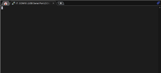

I am using the AM62A    E2 development board purchased by our company, and I use it in the same way as the E1 board. The serial port can be recognized, but I cannot connect to the board through the serial port. What could be the reason?

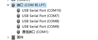

    5.Open Windows Device Manager and it shows 4 COM ports associated with the EVM
    6.Use a serial terminal emulator such as MobaXterm to connect to the first port. Configure the serial port setting to 115200 baud rate, 8 bit, no parity, 1 stop bit, no flow control.
    But unable to connect.
