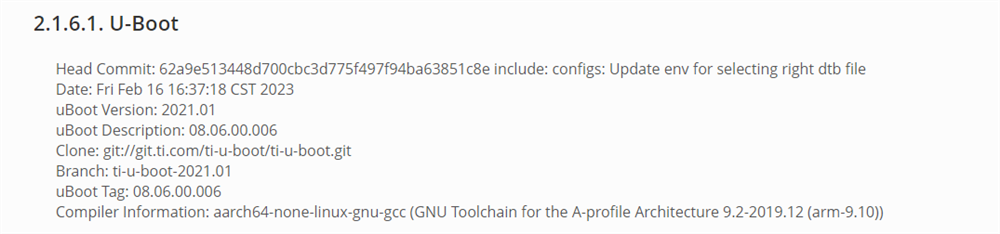

We are using
uboot:
TI PROCESSOR LINUX SDK
08.06.01.02
trustzone image
trusted-firmware-a-2.8+gitAUTOINC+2fcd408bb3

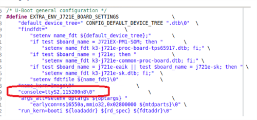

2) include/configs/j721e_evm.h
changed to console=ttyS3

    uboot
    uBoot Version: 2021.01
    uBoot Description: 08.06.00.006
    Clone: git://git.ti.com/ti-u-boot/ti-u-boot.git
    Branch: ti-u-boot-2021.01
    uBoot Tag: 08.06.00.006
    TISDK:
    08.06.01.02

    diff --git a/include/configs/j721e_evm.h b/include/configs/j721e_evm.h
    index 50b018b6ed..d3d5b0b5a7 100644
    --- a/include/configs/j721e_evm.h
    +++ b/include/configs/j721e_evm.h
    @@ -86,9 +86,9 @@
                            "setenv name_fdt k3-j721e-sk.dtb; fi;"  \
                    "setenv fdtfile ${name_fdt}\0"                          \
            "name_kern=Image\0"                                             \
    -       "console=ttyS2,115200n8\0"                                      \
    +       "console=ttyS3,115200n8\0"                                      \
            "args_all=setenv optargs ${optargs} "                           \
    -               "earlycon=ns16550a,mmio32,0x02800000 ${mtdparts}\0"     \
    +               "earlycon=ns16550a,mmio32,0x02810000 ${mtdparts}\0"     \
            "run_kern=booti ${loadaddr} ${rd_spec} ${fdtaddr}\0"
