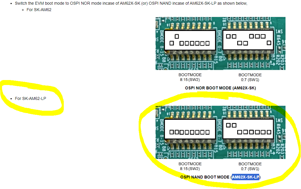

  • Hi Xiong,
    looks like you indeed selected OSPI NAND boot mode, thanks for confirming. So I just searched some more, and this is in fact the correct boot mode for the SK-AM62-LP board. It is not intuitive, but at the end of the day it is about the OSPI read protocol, and the OSPI flash device on that board (W35N01JW) is different from what is on the "regular" SK-AM62 board, and requires this different boot mode to be selected (the protocol is called OSPI 1-1-8 mode, to be specific, as selected by bootmode pins 7 and 8, see TRM).
    Please see here:
    https://software-dl.ti.com/mcu-plus-sdk/esd/AM62X/latest/exports/docs/api_guide_am62x/EVM_SETUP_PAGE.html
    Regards, Andreas

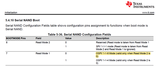

  • Oh, I don't know there is something special for SK-AM62-LP. I understand it a little more then bofore.
    And I am confusing about the doc about the bootmode config now. When the switch is 0000(SW3.4~SW3.7), it shows the boot device is serial NAND.But as you mentioned below. it's using the OSPI 1-1-8 mode actually.
    How should I understand it?
  • But as you mentioned below. it's using the OSPI 1-1-8 mode actually.
    From the TRM...
    Regards, Andreas
