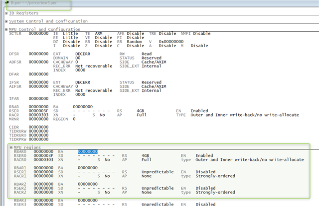

    About your commet
     Usually there are update issues for accesses in DDR if the R5's MPU marks a region as cached.  Making things as write-through can be a work around.  The awareness will have a few levels of indirection and the 0xAxxxxxxx addresses likely are all cached in the captured pictures.
    How can we confirm the memoiy areas  are cached and how go ahead in write-through workaround?
    We ask you some aspects of more T32-Lauterbach related instead of LB support becasue, honestly, your support is being more faster (and detailed) than we are having with the local provider.
    Many thanks
  • Hello Pablo,
    The fast way to check the cache settings for an R5 is to use the percortexr5.per file.  At run time it will fully decode the R5 MPU regions.  Many RTOS will use a static mapping here so sampling once at run time is enough to know.  Some RTOS will dynamically change mappings so extra care would be needed.  The MPU mapping scheme is detailed in the ARM TRM.  The summary is you can enable segments exactly as you use them, or you can map 'overlapping' regions knowing that higher number MPU regions will have priority over lower numbered ones.  Often a specific mapping is in a high number and a catch all is in lower mappings.   For a hack you can change these on the fly in the debugger and see obvious differences in performance in code.  One last note is TCM addresses resolve before the MPU so they will never be cached even if the range is set as such in the MPU.
