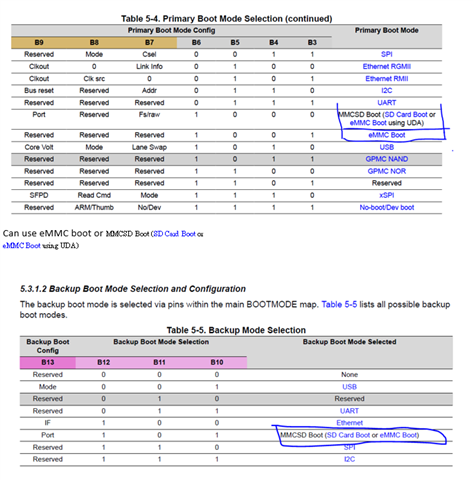

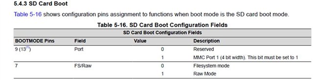

1.How do we need to configure BOOTMODE3-13PIN to start through SD Card? How to configure BOOTMODE3-13PIN if booted through EMMC?

    Please refer the TRM for more information on bootmode configuration
    Query to the expert
    Could you please help me understand if the AM62x supports eMMC backup boot on MMC0 interface.
    Bit 13 0 is reserved and 1 is for MMC1.
    Reply from the expert
    Yes you could set bit 13 to 0 so that port MMC0 would be access for both, but since we only have a single config pin for the backup mode, then it this case the value for the FS/Raw bit would be assume to be filesystem mode. This means that the eMMC device would need to be formatted like a regular SD card to be able to use it as a backup boot mode.

  • We use Linux OS. And we use MMC0 for EMMC and MMC1 for SD card. Maybe we don't need backup mode. We can chnage the BOOTMODE pin CONFIG according to the TRM

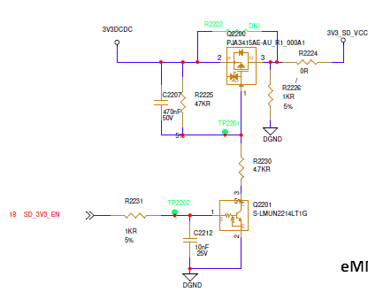

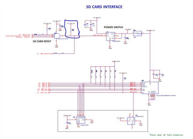

    Please review the comments i have for the SD card interface in the schematics review.
    The Power switch for the SD card supply is required to be ON during power-up to be able to use the SD card interface for boot.
    Please refer SK schematics,
    I marked the pullup.
    Sreenivasa
  • Thanks for your reply. We delete the swith circuit in the desin, Mount a resistor to keep the power supply continuously on, and MMC1 IO pull up use the 3V3DCDC.The 3V3DCDC will always on during power-up, so it's no problem for the SD BOOT. Only some issues with sfatey wuhich we will update in next version update
    This is not recommended, it will cause fail-safe issues - SD card on before SoC power is applied. It is recommended to use VCC_3V3_SYS.
    We have made these recommendations for other peripherals in the schematic review.
