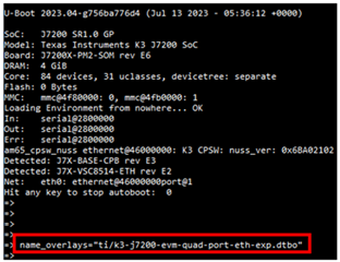

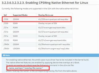

I attempt to enable Native Ethernet according to the TI site CPSWng Native Ethernet page.
I used pre built binary(SDK 09.00.00.07) for DRA821 evm board(Design & development).
I have configurate for enable Native Ethernet(subsystem of CPSWng).

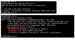

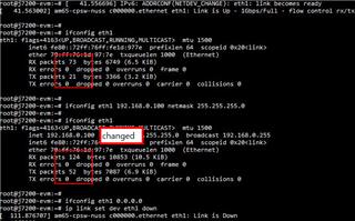

After completing the configuration for Native Ethernet enabling, MAC mode seems not work. Ping test does not work for MAC mode on eth1, eth2, eth3 or eth4.
After ping test, if check ifconfig, rx count is not increase.

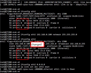

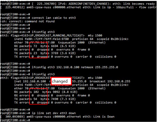

Also, I checked with eth0(CPSW2g) for same environment. It works correctly.
I will attach my test procedure below.

1) Follow the configuration to use the quad port. 3.2.3.6.3.2.3.2.3. Enabling CPSWng Native Ethernet for Linux
Steps in Guide Document Applying and Verifying on the evm Console

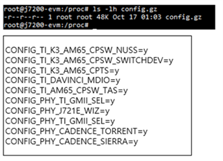

2) Check kernel configuration status. 3.2.3.6.3.2.3.2.2. Driver Configuration

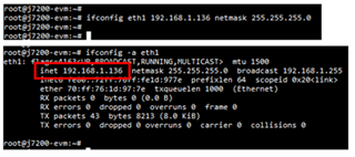

3) Mac mode configuration
    - Mac mode feature method in the CPSW2g Ethernet page guided 3.2.3.6.3.2.3.2.4. MAC Mode.
MAC mode Verifying from the evm Console
- Bringing Up interface
- Get driver information
- ethtool - Display standard
information about device/link

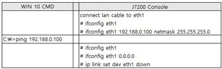

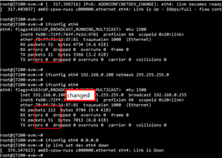

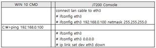

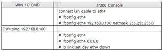

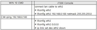

4) Ping test with ETH1 on quad port (rx count NOT changed)
Eth1 Physical Connection Status Eth1 Ping test (evm console)

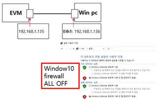

    Also small thing to point out, but according to Diagram, the IP address of EVM is supposed to be 192.168.1.135, but in the ifconfig output screenshot, the IP address assigned to EVM is 192.168.1.136 which is supposed to be windows IP address. Is this some typo?
    Tanmay
  • This occur persistent over multiple boots.
    The IP in the Diagram is a typo.
    Eth1: 192.168.1.136 is EVM side.( 4) Ping test with ETH1 on quad port )

    => name_overlays="ti/k3-j7200-evm-quad-port-eth-exp.dtbo"
    => boot

  • Hi Tanmay,
         Tanmay Patil said:
        Can you confirm that you are able to ping without the bridge interface.
    As your above request, then I do a test like below step. It seem like to a MAC mode. It`s worked well and HW, SDK prebuild image no problem.
    WIN 10 CMD snaphot  command flow J7200 console snapshot
    But tx and rx not changed under ping test in Switch Mode.
    below my test step.
    WIN 10 J7200 console
           J7200 is wait
    I ran the same commands too. It's the same command from the 23rd.
    please recheck the setup on my command and Switch Mode in TI.(3.2.3.6.3.2.3.2.5. Switch Mode)
    If you tell me how to do the your setup Switch mode in TI Command, I'll check it on my side.
