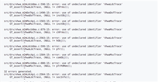

The compilation error is as follows

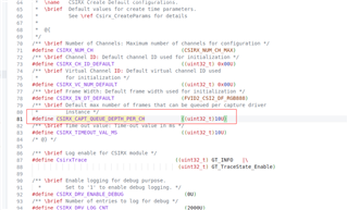

We used the camera to run our algorithm, and found that after running for 2 hours, src/csirx_drv.c @ Line 597: ALLOC: Q object allocation failed error, and then the image does not show the image, but we measure the mipi signal of the camera, and the signal is normal

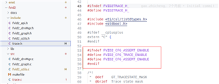

We added some printing where it went wrong, here are the code changes:
Here is the print that went wrong:

We found that Fvid2Utils_dequeue function sometimes returns NULL, but I don't know which function call (This function we need to trace), but CsirxDrv_queue call returns NULL, it will report ALLOC: Q object allocation failed
We need to open GT_*trace to debug, but I added the following macro to packages/ti/drv/fvid2/include/trace.h and found that the pdk compiles with a large number of errors,
编译错误如下
We need your support to help us troubleshoot this issue, how to open GT_*trace debugging to facilitate our troubleshooting,
or do you have any suggestions to help us solve this problem?
