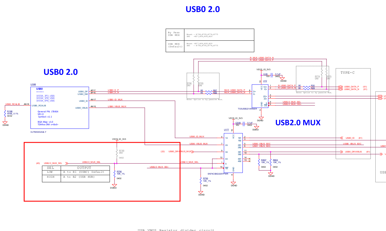

The datasheet for the TDA4VH is pretty clear that there is just 1 USB port (3.0): https://www.ti.com/lit/ds/symlink/tda4vh-q1.pdf?ts=1697634570994&ref_url=https%253A%252F%252Fwww.ti.com%252Fproduct%252FTDA4VH-Q1
I also only see one USB port in the BGA pin map for TDA4VH. However in section 8.4.5.31 of the datasheet there are references to USB3SS0 and USB3SS1.
Additionally, the TRM: https://www.ti.com/lit/zip/spruj52 makes reference to USB0 and USB1 in tables 12-193 and 12-194
Can you confirm how many USB2.0 ports the TDA4VH-Q1 can support without an external hub?
