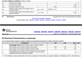

Reading the SPRS717F doc I cannot find the resistance value of the internal GPIO pull-up resistors (and pull-down, if possible to configure for a GPIO).
So when internal pull-up is configured for an input, what values does it have?

There is no actual internal PD resistor. Instead there are weak FETs that pull the signal high or low, typically to control a floating input with no trace routed from the pin.
5.7 DC Electrical Characteristics

So, if I understand this correctly, there is a pull up/ down like circuitry that can provide/ sink up to around 200uA current?
Hello Lukasz Przenioslo
Thank you and your understanding is correct.
