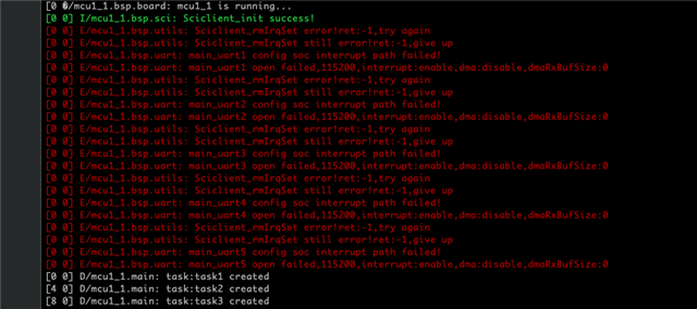

TDA4VM: Interrupt Request from MCU1_1 Failed on SDK8.6
Part Number: TDA4VM
Hi Ti Experts,
Customer is running on TDA4VM SDK8.6 using SBL split mode.
Customer needs MAIN domain UART interrupt request from MCU1_1, but having the below error.
Customer has tried on SDK8.2 before, it does not have this problem.
May I know if the firewall in SDK8.6 has any restrictions on mcu1_1 for doing so?
Customer has also tried that not only the Main Uart interrupt but all the peripheral interrupt in the main domain could not be requested from MCU1_1. (requested from MCU1_0 is normal)
Thanks a lot!
Kevin

  • Hi Jason,
    I don't see what interrupt number are you using. Can you please try getting the interrupt number as per the code below and try:
        struct tisci_msg_rm_irq_set_req     rmIrqReq;
        struct tisci_msg_rm_irq_set_resp    rmIrqResp;
        struct tisci_msg_rm_get_resource_range_resp res = {0};
        struct tisci_msg_rm_get_resource_range_req  req = {0};
        req.type = <Interrupt Router Device ID>;
        req.secondary_host = TISCI_MSG_VALUE_RM_UNUSED_SECONDARY_HOST;
        lSciRetVal  = Sciclient_rmGetResourceRange(&req,
                                              &res,
                                              SCICLIENT_SERVICE_WAIT_FOREVER);
        UART_printf("Sciclient_rmGetResourceRange retval = %d\n",lSciRetVal);
        lSciRetVal = Sciclient_rmIrqTranslateIrOutput(req.type,
                                                      res.range_start,
                                                      <Destination Core Device ID>,
                                                      &intNum);
    Parth
  • Hi Parth:
    For example, I want to use uart3 in mcu1_1, the interrupt number i using is MAIN_UART3_INT_NUM(163) which define above.
    In MCU1_0:
    We can use uart3 or other main domain peripheral in mcu1_0,the log is below:
    [9 0] D/mcu1_0.bsp.uart: mcu_uart0 open success,460800,interrupt mode,rxBufSize:4
    [17 0] D/mcu1_0.bsp.utils: src_id:280,src_index:0,dst_id:250,dst_host_irq:163
    [24 0] E/mcu1_0.bsp.utils: Sciclient_rmIrqTranslateIrOutput fail,retval:-2,req.type:280,res.range_start:0,dstId:250,dst_input:41025
    [38 0] D/mcu1_0.bsp.uart: main_uart3 open success,460800,dma mode,rxBufSize:4
    We call BSP_Utils_RmIrqSet() function to route main domain uart interrupt to mcu1_0.And you can see that the rmirqReq struct we fill in:src_id:280,src_index:0,dst_id:250,dst_host_irq:163
    rmIrqReq.src_id = perId;
    rmIrqReq.src_index = perIdx;
    rmIrqReq.dst_id = coreDevId;
    rmIrqReq.dst_host_irq = outputIdx;
    In MCU1_1:
    [5 0] D/mcu1_1.bsp.uart: mcu_uart0 open success,460800,interrupt mode,rxBufSize:4
    [13 0] E/mcu1_1.bsp.utils: src_id:280,src_index:0,dst_id:251,dst_host_irq:163
    [23 0] E/mcu1_1.bsp.utils: Sciclient_rmIrqSet error!ret:-1
    [30 0] E/mcu1_1.bsp.utils: Sciclient_rmIrqTranslateIrOutput fail,retval:-2,req.type:280,res.range_start:0,dstId:251,dst_input:0
    [45 0] E/mcu1_1.bsp.uart: main_uart3 config soc interrupt path failed!
    [53 0] E/mcu1_1.bsp.uart: main_uart3 open failed,460800,dma mode,rxBufSize:4
    We CAN NOT use uart3 or other main domain peripheral in mcu1_1,the log is below:
    You can see that the rmirqReq struct we fill in:src_id:280,src_index:0,dst_id:251,dst_host_irq:163
    src_id = TISCI_DEV_UART2
    src_index = 0
    dst_id = TISCI_DEV_MCU_R5FSS0_CORE1
    dst_host_irq = CSLR_MCU_R5FSS0_CORE1_INTR_MAIN2MCU_LVL_INTRTR0_OUTL_0 + 2
    I tried your code and write it as a function call BSP_Utils_RmIrqGet(), but you can see that it return error every time, the code is below:

  • Hi Jason,
    The res.type should be the device ID of the interrupt router used, in this case it should be the device ID of J721E_DEV_MAIN2MCU_LVL_INTRTR0 and not the UART3
    Main UART3 interrupt can be routed to MCU domain R5F i.e MCU1_0 and MCU1_1 via J721E_DEV_MAIN2MCU_LVL_INTRTR0. Sciclient_rmIrqSet API will take care of routing this interrupt if given proper parameters.
    Can you first please try with the suggestion of using interrupt router device ID as mentioned in the first comment and confirm if it is working properly, then I'll add the complete description.
    Parth
  • Hi Parth,
    Thanks a lot, it work after we change the wrong parameters, we use the follow code to route the interrupts

        req.secondary_host = (uint8_t)TISCI_MSG_VALUE_RM_UNUSED_SECONDARY_HOST;
        res.range_num = 0;
        res.range_start = 0;
        retVal =  Sciclient_rmGetResourceRange(
                    &req,
                    &res,
        if (CSL_PASS != retVal || res.range_num == 0) {
            /* Try with HOST_ID_ALL */
            req.type           = ir_id;
            req.subtype        = (uint8_t)TISCI_RESASG_SUBTYPE_IR_OUTPUT;
            req.secondary_host = TISCI_HOST_ID_ALL;
                    &req,
                    &res,
        if ((CSL_PASS == retVal) && (res.range_num != 0))
            *irq_range_num = res.range_num;
            /* Translate IR Idx to Core Interrupt Idx */
            irIntrIdx = res.range_start;
            retVal = Sciclient_rmIrqTranslateIrOutput(ir_id,
                                                      irIntrIdx,
                                                      dst_id,
                                                      irq_range_start);
        if (retVal == CSL_PASS)
            retVal = 0;
        else
            retVal = 1;
        return retVal;
    int32_t BSP_Irq_ConfigInterruptRouter(uint16_t perId,uint32_t perIdx,uint32_t *intNum)
        int32_t ret;
        uint16_t ir_id = 0U, irq_range_start = 0, irq_range_num = 0;
        uint16_t dst_id = 0;
        static uint32_t irqNum = 0;
        (void)memset (&rmIrqReq, 0, sizeof(rmIrqReq));
        rmIrqReq.valid_params |= TISCI_MSG_VALUE_RM_DST_ID_VALID;
        rmIrqReq.valid_params |= TISCI_MSG_VALUE_RM_DST_HOST_IRQ_VALID;
        rmIrqReq.global_event = 0U;
        rmIrqReq.dst_id = BSP_Utils_GetSciDomain();
        rmIrqReq.ia_id = 0U;
        rmIrqReq.vint = 0U;
        rmIrqReq.vint_status_bit_index = 0U;
        rmIrqReq.secondary_host = TISCI_MSG_VALUE_RM_UNUSED_SECONDARY_HOST;
        dst_id = rmIrqReq.dst_id;
        #ifdef BUILD_MCU1_0
        ir_id = BSP_Irq_GetInterruptRouterId(TISCI_DEV_MCU_R5FSS0_CORE0);
        #elif defined BUILD_MCU1_1
        ir_id = BSP_Irq_GetInterruptRouterId(TISCI_DEV_MCU_R5FSS0_CORE1);
        #endif
        ret = BSP_Irq_GetIrqRange(ir_id,dst_id,&irq_range_start, &irq_range_num);
        if(ret)
            LOG_E("BSP_Irq_GetIrqRange fail!");
        if(irqNum<irq_range_num){
            rmIrqReq.dst_host_irq = irq_range_start+irqNum;
            irqNum++;
        else{
            ret = 1;
            LOG_E("irq resource ran out!,max irqs:%d",irq_range_num);
            return ret;
        ret = Sciclient_rmIrqSet(&rmIrqReq, &rmIrqResp, SCICLIENT_SERVICE_WAIT_FOREVER);
        if (CSL_PASS != ret)
            LOG_E("irq_range_start:%d,irq_range_num:%d",irq_range_start,irq_range_num);
            LOG_E("src_id:%d,src_index:%d,dst_id:%d,dst_host_irq:%d",
                  rmIrqReq.src_id,rmIrqReq.src_index, rmIrqReq.dst_id, rmIrqReq.dst_host_irq);
            LOG_E("Sciclient_rmIrqSet error!ret:%d", ret);
        else
            // LOG_D("src_id:%d,src_index:%d,dst_id:%d,dst_host_irq:%d",
            //       rmIrqReq.src_id,rmIrqReq.src_index, rmIrqReq.dst_id, rmIrqReq.dst_host_irq);
        *intNum = rmIrqReq.dst_host_irq;
        return ret;
