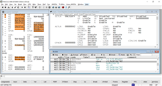

  • Hello Lucas,
    For your reference, I ran L2 cache testing using Lauterbach T32 JTAg debugger with Linux SDK 8.2 on AM335x EVM
    1/. stop @u-boot, L2 cache is enabled as shown below
    2/. I'm able to modify CP15 SCTLR and ACTLR directly via JTAG debugger as listed below
    -Hong

  • Hello Lucas,
    I used Linux SDK 8.2 prebuilt binary on AM335x EVM in my test.
    As noted in my last reply.
    1/. The screenshot #1 is where I attached JTAG debugger, and paused u-boot running @u-boot prompt.
    2/. @u-boot prompt, I was able to modify CP15 SCTLR and ACTLR to disable L2 cache directly via JTAG debugger as shown in the screenshot #2.
    -Hong
