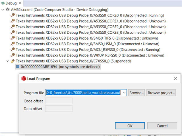

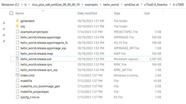

I build the C7x hello world example:
boot SK-AM62A board with Linux SDK 09.00.01.03 from SDK card.

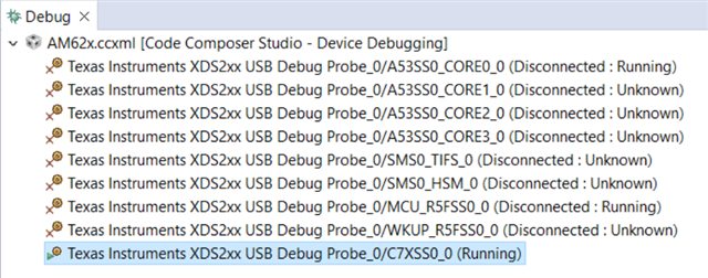

Connect C7x DSP core  and download .out.
It can't stop on main after downloading, and in Running status.

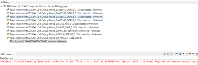

Suspend from menu, stop on below:
Reset CPU from menu, and reload, error as below, can't load.

  • Hi Tony,
    Sorry for the delay in responding. We currently don`t fully support use of C7x on AM62A as general purpose DSP. We intend to explore this in 2024 but currently are not supporting this fully with the SDK even if MCU+ SDK does have FreeRTOS support and driver support with MCASP, IPC, etc
    Please reach out to Vaibhav Mahimkar and me over email if you have a customer usecase and opportunity where we can provide some early access material and provide a roadmap to this usage.
