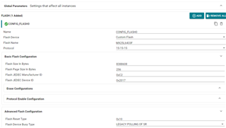

Issue of UART uniflash of custom flash
SDK:mcu_plus_sdk_am64x_09_00_00_35
CCS:Version: 12.4.0.00007
custom flash: MX25L6433F
(1)Accord to  AM64x MCU+ SDK: Adding Support For a Custom Flash Device (ti.com)     I completed the configure and run example: (a)ospi_flash_diag (b)ospi_flash_io , all passed
(2) Did the custom flash configure in sbl_dfu_uniflash, the example run ok, and AM6442 boot ok
While it failed in sbl_uart_uniflash,  I rebuilt the two image: sbl_uart_uniflash.debug.hs_fs.tiimage and sbl_ospi.debug.hs_fs.tiimage
Please help me resolving the issue.

  • HI, Prashant. This problem is partly resolved, but i do not know why, please check and reply.
    (1) with the same custom flash configure, it failed in AM64x_evm project, but pass in AM64x_sk project. My AM6442 device type is HSFS .
    (2) compare the two projects, evm and sk, i copy the MMCSD interface of evm project from sk project, Card_Type: NO_DEVICE, then evm project was ok
    I do not know why the project must active MMCSD? I tried close MMCSD, project compiled failed.
    Thanks!
