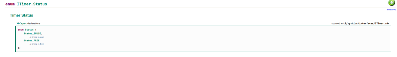

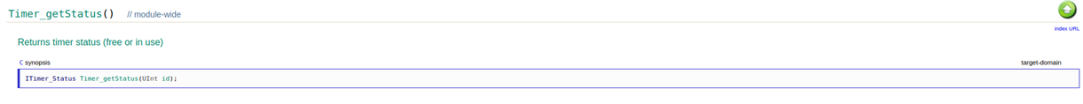

I changed the Dsp1,Dsp2 DTS as below, but in linux, it still goes to crash as Timer_create(5,...), my DSP1 application.
As I call Timer_getStatus(5), it shows 1, that means available, right?
Would you show me what need to do to have a second timer in DSP1?
