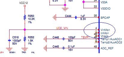

Now, I am using the C6670 for design. And I am puzzled by the Power Supply of the C6670. From the TI's reference design guide, I know the UCD9222+UCD7242 should be used to provide the C6670's Core Power supply. I have some question about the 6670L schematic on Page 33.
Question 1#: The Pin 4 of the UCD9222 have a voltage( about 1.5v: 12v * (1.5k/(10.2k+1.5k))), The voltage we need for the 6670 core is 1.0v. How this voltage used for?

  • Pin 4 of the UCD9222 is the VinMON pin.  This pin is connected to a 12-bit ADC which allows the device to monitor the input voltage for the device.  The 12-bit ACD is limited to a dynamic range of 0 to 2.5V so an external resistor divider is required to limit the input voltage range at the VinMON pin.  The scaling of the voltage is then defined in the part using the VIN_SCALE_MONITOR command.  Once this is done the device can monitor the input voltage which is used in a number of alerts.
