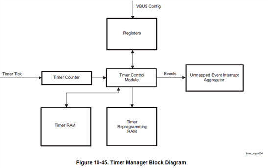

It is a little confusing the different graphs that exist in the TRM (version 2.0). I share the photos in the following and explain what are the conflicts.

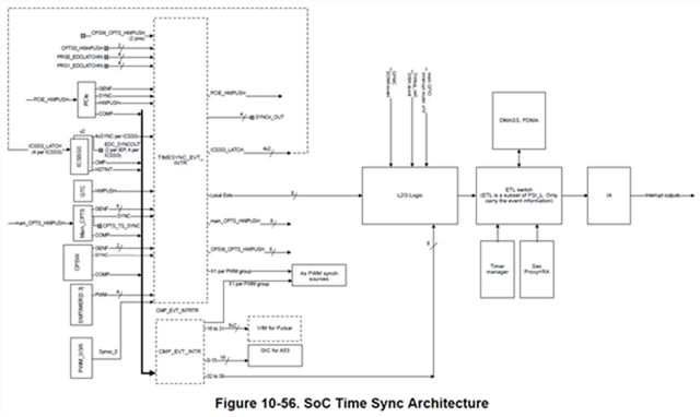

In figure 10-45 it shows that the events that are coming from Time Manager are unmapped events going to Interrupt Aggregator. In figure 11-219 it shows the unmapped events are coming from ETL to Interreupt aggregator (not directly), the same for figure 11-4.

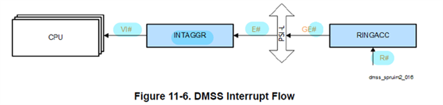

In figure 11-4 it shows secure proxy events are coming from PSI-L, while in figure 10-56 it shows they are coming through ETL to Interrupt Aggregator.
In the other hand in the explanation of ETL it is mentioned it is a subset of PSI-L, a lane for transferring events. However in the figure 11-4 it is demonstrated as a separate block and in figure 11-219 events coming from PSI-L are differed from events coming from ETL; the first one is called Mapped Local events and the second one as unmapped events coming through ETL. Therefore, it seems they are not finally the same.

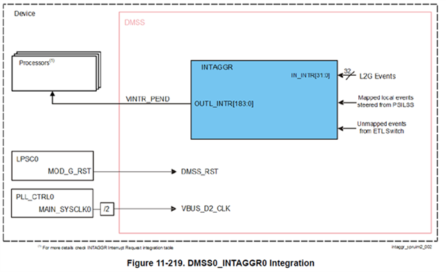

Also in figure 11-219 we see that the events going to Interrupt Aggregator are categorized into three category:
  1. L2G : However in figure 10-56  it shows that it first goes to ETL first then Interrupt Aggregator, so why it is not in the second category??
  2. Local mapped events steered from PSI-L: Is it that events coming through PSI-L are mapped and if not from PSI-L they are not mapped? What are the events that are in this category? Are they global?
  3. Local unmapped events coming from ETL. What are the events that are in this category? Are they global?
Each event category consist which events?
What is the difference of mapped and unmapped events?
L2G consists local events, however based on the name I believe the output of it should be global. So is it global events entering to Interrupt aggregator?

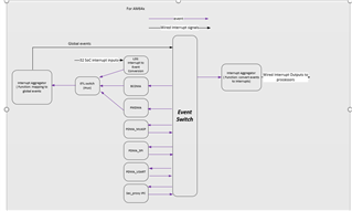

  • Before I answer your specific questions, I wanted to list a few things which help explain the interrupt aggregator and ELT and all the events:
    1. Interrupt aggregator includes three orthogonal functions:
      1. one is event mapping block which converts local/umapped event to global event and send those events out.
      2. Second is aggregating global events and convert them into interrupt outputs
      3. Third is the L2G block:this is a block to convert the event/interrupt from SoC level into global events. L2G block takes wired signal from SoC  (interrupt signal or DMA signal) converted into local events.
    2. L2G: this is a block to convert the event/interrupt from SoC level into global events. L2G block takes wired signal from SoC  (interrupt signal or DMA signal) converted into local events. Those local events are sent to ETL and sent to event mapping logic inside interrupt aggregator to convert them into global event. And then those global events are sent out again.
    3. PSIL and ETL: PSIL is a streaming protocol which carries both data information and event information.  ETL is the PSIL portion which only carries event. PSIL data is transported independently. When you see PSIL, it must include ETL.
    4. Local events and unmapped events are in the same category. All those unmapped/local events are  routed to  the mapping block inside Interrupt aggregator to be converted into global events
    5. Other than L2G block, Currently there are only three components generating unmapped events: BCDMA, PktDMA and timer manager. All those unmapped events are routed to the event mapping block inside interrupt aggregator first. All the other components produce global events.
    6. After the local/unmapped events are mapped to global events in interrupt aggregator, those global events are sent out by interrupt aggregator and can be transported to different locations ( for example, BCDMA to trigger BCDMA or pktDMA  or going back to interrupt aggregator’s aggregating global events into interrupts.
    I draw a picture to demonstrate the concepts I described above: I do not know how to attach the picture to the response. I will ask my college for help.

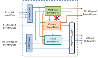

    In the meantime, I found a figure in the Errata file for AM243x which with your explanation makes it more clear.
    Would you please correct my understanding if it's wrong:
    The events that are unmapped/local (BCDMA, PKTDMA, Timer Manager) go to the unmapped module to make it to global events. It is done by unmapped register sets by assigning them a global index in addition to defining the type of interrupt (edge/level). This module generates global events.
    The Soc Events that are local (like GPIO, TimeSynch, etc) go to the L2G module and it converts them to global by assigning them a global index in addition to defining the type of interrupt (edge/level). This module generates global events.
    Global Events generated on the Unmapped Module or L2G module, as well as other events (that are inherently global), can go to the MultiCast Block to be used for triggering the BCDMA/PKTDMA  or to be sent to other modules that are connected to PSIL and can receive an event from that.
    Based on your explanation, I believe the module VINT Status Bits is the module that generates interrupts based on global events.
    1. However, it is not clear to me what is the "Counted Event Block" and why there is a connection between MultiCast Block, Counted Event Block, and Status Event Block.
    2. Does Counted Event Block really count the number of global events coming? Does it mean that when we split a global event into two, we need to count it two times one time going directly to this block and one time from Multicast to this block to count it two times?
    3. If the above is correct, then why the output of all these three blocks are getting into the VINT Status Bits? In this case, we are sending the same global event three times to the VINT Status block.
    Thank you so much for your time.

  • There are some content missing from the TRM to explain the countable global events. I've already flag this to our internal team for the future TRM update.
    Each countable global event has two MMR, one is GEVI[a].MAP and the second one is GEVI[a]_COUNT. The count register is self explanatory, which is tracking  # of event count for this global countable events. When one global event is generated with this event index, the event count is increased by one. When one of the end point consumes this global event with this index, the event count will be reduced by one. This operation is tracked by HW automatically.
    The GEVI[a]_MAP register, the following explains the two modes it supports:
    The countable global events generate either an event ( when irqmode is set to 0) or an interrupt ( when irqmode is set to 1) when the count of the events goes from zero to non-zero or from non-zero to zero.
    When irqmode is set to 0, the gevidx field is determine the global event index this event sent out to the system.
    when irqmode is set to 1, the gevidx field is used to set the mapper register for the virtual interrupt. bit14:6 is used to determine which virtual interrupt this countable event sent to and  bit 5:0 is determine the bit fields of 64 possible bit for the virtual interrupt.
    The below are the register definition for countable event for your reference. I hope it helps clarifying your question.
