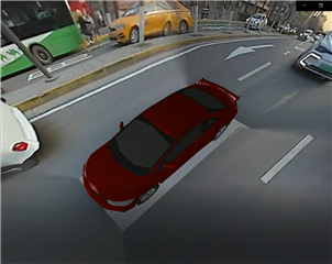

TDA4VE-Q1: GPU 3D model rendering
Part Number: TDA4VE-Q1
When I use GPU to render 3D car model, there will be an error, I hope to get your help, the effect is as shown in the following picture, log.txt is the log saved at runtime.
sdk used:
ti-processor-sdk-linux-adas-j721s2-evm-09_00_00_08
ti-processor-sdk-rtos-j721s2-evm-09_00_00_02

    This issue only occurs on sdk9.0 and occurs when rendering in 3D, not 2D.  The same algorithm does not have this issue on sdk8.6.

    2) On SDK 9.0, there is an issue where the application renders badly, like the picture above, and also the stuck issue
    3) On SDK 9.1, there is an issue where the applicataion renders badly, but does not get stuck

    Are you still seeing the original failure? Or are you seeing something else? Currently I see only black, and not these colors as you are showing. Are you seeing GPU logs? I see one hardware recovery when I run your application.
    Erick
  • Hi Erick,
    The problem is the 3D car model can't show out. The black zone is below the 3D car model.
    Best Regards
    Waley
  • The problem is that the 3D car model can't be shown out as below.
  • Waley,
    I see two viewports. The one on the left-hand side and the one on the right hand side.
    The one on the left shows a car model, but the one on the right does not. Is the car model on the left-hand side the expected car model? And it is just not showing in the viewport on the right?
    Erick
  • Hi Erick,
    The car model on left side is only a 2D picture overlay, it is no problem.
    The car model on right side is real 3D model, it is the problem point.
    Waley
  • Waley,
    Thank you for clarifying that. Let me take a look at the APIs that are being called. I suspect not a driver issue but a rendering issue in the OpenGL calls.
    How are you rendering the car model? What model format are you using?

  • Waley,
    I've gone through and updated my GPU driver on SDK 9.1 to the SDK 9.2 GPU version (23.3).
    I've seen you car model render correctly now. You have two options:
    1) Upgrade to SDK 9.2, it has the newest GPU driver
    2) Upgrade the GPU driver in SDK 9.1 to the 23.3 driver.
    If you upgrade to SDK 9.2, this would be simpler since you don't need to do any custom upgrade to the GPU driver, but if this is a lot of work I can explain how to update the GPU driver on SDK 9.1. Let me know which you prefer.
    Erick
