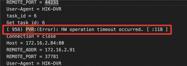

The problem is as shown below. Currently, there is a very low probability that the problem will occur

There is no PVR related printing in stdout. the probability of occurrence in the product is very low. Less than ten motherboards have this problem.We would like to prioritize whether there is a hardware issue
Details:Between one to two hours of normal operation of the board, the appearance of the above image suddenly appears. During this period, you can switch views or execute 3D animations. it will automatically return to its normal display at random time.

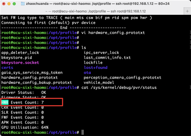

Today's test, there is a flower screen problem.The patch package added for this test. The name of the patch package is patch_11.13_PP131820_CL633615.tgz.
Help analyze the problem. thank you.

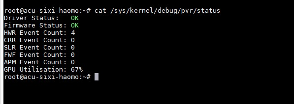

Flower screen front :HWR Event Count:1
Flower Screen :HWR Event Count:2
Screen restoration : HWR Event Count:3

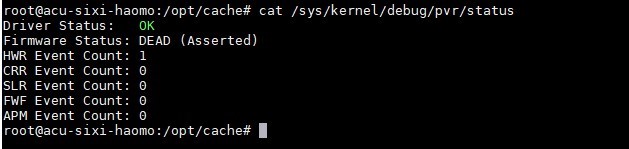

Can you please run the following command before you start your application:
echo Y > /sys/kernel/debug/pvr/apphint/0/AssertOnHWRTrigger
pvrdebug -loggroups main,mts,cleanup,csw,bif,pm,rtd,spm,pow,hwr
Then, collect the pvrlogdump when you experience a hardware recovery. The first command will cause the GPU to freeze and save the firmware state when an issue occurs. That will provide us a snapshot and give us something to analyze.
Erick
Hi,Ercik
In the process of repetition avm does not have a Mosaic screen, but the screen continues to be black once. I have obtained the relevant log according to the method, please help analyze it.
Thanks.
Li,
Thanks, I'm sharing these logs with the team for analysis. The black screen is expected as the FW is frozen using this method and no more GPU processing is handled.
