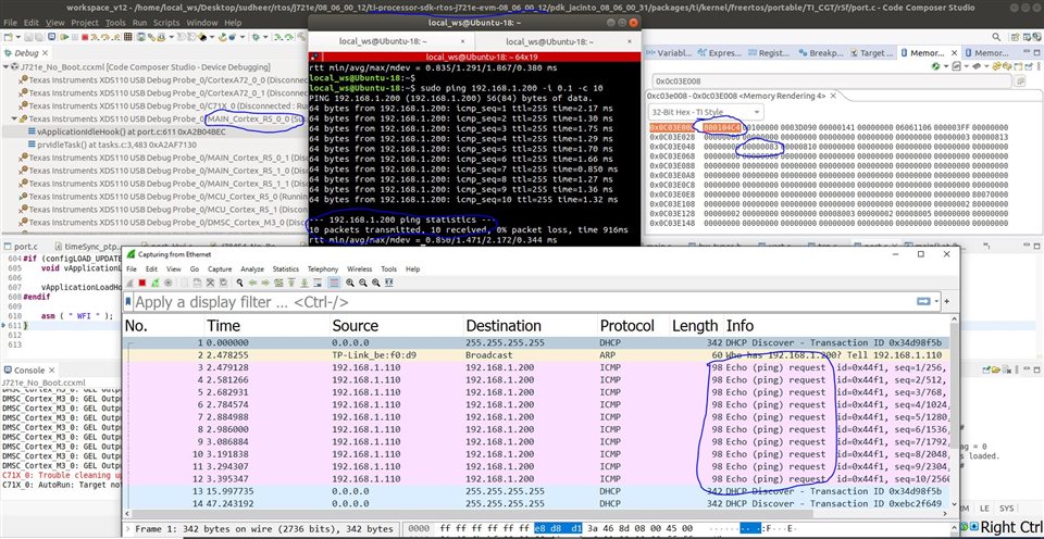

    Destination port mirroring:
    Please refer to the below patch, which provides a reference for mirroring Port-3 traffic to Port-1 (whatever packets are sent out/egress from Port-3 will also egress from port-1).
    Patch: (SDK: ti-processor-sdk-rtos-j721e-evm-08_06_00_12)
    https://e2e.ti.com/cfs-file/__key/communityserver-discussions-components-files/791/0001_2D00_Enabled_2D00_Destination_2D00_Port_2D00_mirroring_2D00_example_2D00_from_2D00_Port_2D00_3_2D00_to_2D00_Port_2D00_1.patch
    Sample Output with the above test:
    Source port mirroring:
    Please refer to the below patch, which provides a reference for mirroring of Port-3 input/ingress traffic to Port-1 (whatever packets received/ingress on Port-3 will egress from port-1)
    https://e2e.ti.com/cfs-file/__key/communityserver-discussions-components-files/791/0001_2D00_Enabled_2D00_Source_2D00_Port_2D00_mirroring_2D00_example_2D00_from_2D00_Port_2D00_3_2D00_to_2D00_Port_2D00_1.patch
    Sample Output with above test:
