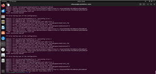

    The command execution result still has an error:
    Although the previous instruction execution error occurred, I continued to modify 'k3-am62a-mcu.dtsi' and then used make linux, but the compilation did not pass.
    Can you help me point out which steps are incorrect and send me the correct steps you used for comparison?
    I re-did the experiment, reinstalling ti-processor-sdk-linux-edgeai-am62axx-evm-09_00_01_03-Linux-x86-Install.bin and directly doing make install. Then, following this link: https://software-dl.ti.com/jacinto7/esd/processor-sdk-linux-edgeai/AM62AX/09_00_00/exports/docs/linux/How_to_Guides/Target/How_to_test_MCAN_on_AM62x.html#enable-device-tree-overlay, modified k3-am62a-mcu.dtsi and 'make install' again.
    make[3]: *** [scripts/kconfig/Makefile:77: syncconfig] Error 1
    make[2]: *** [Makefile:704: syncconfig] Error 2
    make[1]: *** [Makefile:805: include/config/auto.conf.cmd] Error 2
    make[1]: *** [include/config/auto.conf.cmd] Deleting file 'include/generated/rustc_cfg'
    make[1]: unlink: include/generated/rustc_cfg: Permission denied
    make[1]: *** [include/config/auto.conf.cmd] Deleting file 'include/generated/autoconf.h'
    make[1]: unlink: include/generated/autoconf.h: Permission denied
    make[1]: Leaving directory '/home/ruihua.pan/work/board-support/linux-6.1.46+gitAUTOINC+f8110d9ce8-gf8110d9ce8'
    make[1]: Entering directory '/home/ruihua.pan/work/board-support/linux-6.1.46+gitAUTOINC+f8110d9ce8-gf8110d9ce8'
      SYNC    include/config/auto.conf.cmd
    fopen: Permission denied
    *** Error during sync of the configuration.
    make: *** [makerules/Makefile_linux-dtbs:10: linux-dtbs] Error 2

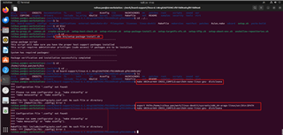

  • setp 2:
    export PATH=/home/ruihua.pan/work/linux-devkit/sysroots/x86_64-arago-linux/usr/bin:$PATH
    Try using a path of `.../linux-devkit/sysroots/x86_64-arago-linux/usr/bin/aarch64-oe-linux` and a CROSS_COMPILE prefix of `aarch64-oe-linux-`. Looks like our Linux SDK user's guide wasn't updated to reflect the changes that we made going from SDK v8.x (uses "external toolchain") to SDK v9.x (uses "Yocto-internal toolchain).
    I filed an internal ticket (SITSW-3205) to get our docs updated.
    Regards, Andreas
  • Hi  Andreas,
    Are these two commands used? After entering these two commands, the ls command cannot be used.
    export PATH=/home/ruihua.pan/ti-processor-sdk-linux-edgeai-am62axx-evm-09_00_01_03/linux-devkit/sysroots/x86_64-arago-linux/usr/bin/aarch64-oe-linux
    make ARCH=arm64 CROSS_COMPILE=aarch64-oe-linux- distclean
    Regards,Daohong
  • Looks like you forgot adding the existing $PATH at the end of your new PATH definition. Open a new shell and try it again.
    Regards, Andreas
  • Hi  Andreas,
    It seems there's still a problem.
    Regards,Daohong
  • Can you confirm you can access that compiler from the command line, like this?
    a0797059@dasso:~/ti/ti-processor-sdk-linux-edgeai-am62axx-evm-09_00_01_03
    $ export PATH=/home/a0797059/ti/ti-processor-sdk-linux-edgeai-am62axx-evm-09_00_01_03/linux-devkit/sysroots/x86_64-arago-linux/usr/bin/aarch64-oe-linux:$PATH
    $ aarch64-oe-linux-gcc --version
    aarch64-oe-linux-gcc (GCC) 11.3.0
    Copyright (C) 2021 Free Software Foundation, Inc.
    This is free software; see the source for copying conditions.  There is NO
    warranty; not even for MERCHANTABILITY or FITNESS FOR A PARTICULAR PURPOSE.
    $ which aarch64-oe-linux-gcc
    /home/a0797059/ti/ti-processor-sdk-linux-edgeai-am62axx-evm-09_00_01_03/linux-devkit/sysroots/x86_64-arago-linux/usr/bin/aarch64-oe-linux/aarch64-oe-linux-gcc
    With this same setup I also just confirmed I can build the Kernel without issues...
