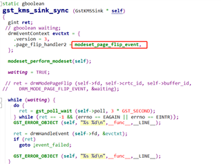

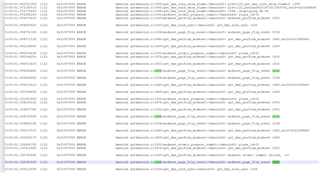

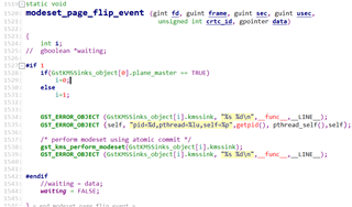

    I made the change myself. I'm going to change set_plane to atomic. But the callback function fires three times in a row. I just want field blanking to trigger once and atomic commit once.
    Does page_flip_handler2 trigger a function once every field blanking?
