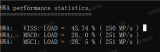

In TI's document, it mentions that the VPAC3 in TDA4VH has a processing capacity of 720 MP/s.
But in our test using multi_cam_app running with 4 x 3C10 (2M) cams, the VISS utilization is 45.74% (250MP/s). With this data, we can calculate when the utilization is up to 100%, the processing rate is only 547 MP/s, which is far below than 720MP/s.
Could you please help me check the cause of such a big difference, thank you very much.
