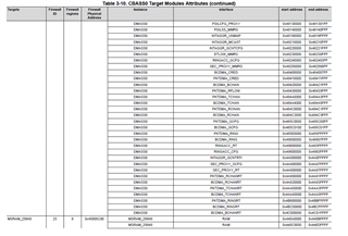

  1. when in the TRM it talks about the channelized firewalls is it talking about the following? or is it sth else?
    AM64x channelized firewalls are listed at https://software-dl.ti.com/tisci/esd/latest/5_soc_doc/am64x/firewalls.html?highlight=channelized#list-of-channelized-firewalls .

    I have seen this link before. The section is empty.
    Section is empty as there are no modifiable channelized firewalls on AM64x. See TRM (revision H) section 3.8.3 Firewall Block
