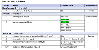

We are using the TDA4VM SOC in our design . The Boot configuration is set it as OSPI boot. The Boot flash device part# MT35XU02GCBA1G12-0AUT. While the module is powered ON, all the TDA SOC power supply voltages are generated from PMIC. The PMIC is able to release the reset signal as per the below drawing.
TI shared two flash file and flashed the file as per the below recommended location.
After loading the 2 files (not sure its flashed properly). But we verified the data stored in the device against the file and it seems to be fine. However, after loading the files, the UART log is below.
Is there anything that I need to look on to the Hardware to ensure everything is good for processor boot. And also, what could be the reason for this log.
Looking for your help in this regard.
Thanks-Arumugam
    Before moving to boot from OSPI, did you validate the OSPI interface with some example applications?
    Do you have any other boot mode available? Can you try running OSPI driver example
    Parth
  • Hi, we put the SOC in no boot option and then tried to connect to JTAG emulator. But unfortunately, the EMU status not available msg received from UART debugger. Now we are trying to put the SOC in UART boot mode. Can you relate the EMU fault status with processor not boot in OSPI mode.
    We are able to flash the NOR flash device using our NOR flash programmer.
  • Please share the delta patch on the SBL, there is an issue with the SBL configuration for the flash and hence the Board_flashOpen() is failing, leading to a failure in loading TIFS (or Sysfw).
    Karan
  • Here is the SBL src code we used. There were no modification on this file. instead we have modified the m35xu512.h with the updated manufacture ID as ZF is using the same family of device but with a larger density and it has four die stack. as well as the DDR reg that was generated from the DDR config tool.

    /** Macro to enable 4 byte addressing */
    /* #define EXT_ADDRESS_ENABLE        (0U) */
    /** FLASH device specific items (note: sizes are in bytes) */
    #define NOR_BLOCK_SIZE               (128U * 1024U)
    #define NOR_SECTOR_SIZE              (4U * 1024U)
    #define NOR_SIZE                     (64U * 1024U * 1024U)
    #define NOR_NUM_BLOCKS               (NOR_SIZE / NOR_BLOCK_SIZE)
    #define NOR_NUM_SECTORS              (NOR_SIZE / NOR_SECTOR_SIZE)
    #define NOR_PAGE_SIZE                (256U)
    #define NOR_NUM_PAGES_PER_SECTOR     (NOR_SECTOR_SIZE / NOR_PAGE_SIZE)
    #define NOR_NUM_PAGES_PER_BLOCK      (NOR_BLOCK_SIZE / NOR_PAGE_SIZE)
    /** Flash device commands */
    #define NOR_BE_SECTOR_NUM            (-1U)
    #define NOR_CMD_BULK_ERASE           (0x60U)
    #define NOR_CMD_WRR                  (0x01U)
    #define NOR_CMD_WREN                 (0x06U)
    #define NOR_CMD_RDSR                 (0x05U)
    #define NOR_CMD_RDCR_VOL             (0x85U)
    #define NOR_CMD_RDCR_NVOL            (0xB5U)
    #define NOR_CMD_RDID                 (0x9FU)
    #define NOR_CMD_RSTEN                (0x66U)
    #define NOR_CMD_RST_MEM              (0x99U)
    /** Different commands for 4 byte addressing and 3 byte addressing */
    #ifdef EXT_ADDRESS_ENABLE
    #define NOR_CMD_BLOCK_ERASE          (0xDCU)
    #define NOR_CMD_SECTOR_ERASE         (0x21U)
    #define NOR_CMD_READ                 (0x13U)
    #define NOR_CMD_FAST_READ            (0x0CU)
    #define NOR_CMD_OCTAL_O_FAST_RD      (0x7CU)
    #define NOR_CMD_OCTAL_IO_FAST_RD     (0xCCU)
    #define NOR_CMD_OCTAL_READ           (NOR_CMD_OCTAL_O_FAST_RD)
    #define NOR_CMD_PAGE_PROG            (0x12U)
    #define NOR_CMD_OCTAL_FAST_PROG      (0x84U)
    #define NOR_CMD_EXT_OCTAL_FAST_PROG  (0x8EU)
    #define NOR_CMD_OCTAL_PROG           (NOR_CMD_OCTAL_FAST_PROG)
    #else
    #define NOR_CMD_BLOCK_ERASE          (0xD8U)
    #define NOR_CMD_SECTOR_ERASE         (0x20U)
    #define NOR_CMD_READ                 (0x03U)
    #define NOR_CMD_FAST_READ            (0x0BU)
    #define NOR_CMD_OCTAL_O_FAST_RD      (0x8BU)
    #define NOR_CMD_OCTAL_IO_FAST_RD     (0xCBU)
    #define NOR_CMD_OCTAL_DDR_O_FAST_RD  (0x9DU)
    #define NOR_CMD_OCTAL_DDR_IO_FAST_RD (0xFDU)
    #define NOR_CMD_PAGE_PROG            (0x02U)
    #define NOR_CMD_OCTAL_FAST_PROG      (0x82U)
    #define NOR_CMD_EXT_OCTAL_FAST_PROG  (0xC2U)
    #define NOR_CMD_WRITE_VCR            (0x81U)
    #define NOR_CMD_READ_VCR             (0x85U)
    #endif
    /* \brief Read ID command definitions */
    #define NOR_RDID_NUM_BYTES           (0x3U)
    #define NOR_MANF_ID                  (0x2CU)    /* Manufacturer ID */
    //#define NOR_DEVICE_ID                (0x5B1A)   /* Device ID */
    #define NOR_DEVICE_ID                (0x5B1C)   /* Device ID */
    /** Status Register, Write-in-Progress bit */
    #define NOR_SR_WIP                   (1U << 0U)
    /** Dummy cycles for Read operation */
    #define NOR_SINGLE_READ_DUMMY_CYCLE  (0U)
    #define NOR_OCTAL_READ_DUMMY_CYCLE   (30U)
    /** In Micro seconds */
    #define NOR_PAGE_PROG_TIMEOUT        (400U)
    #define NOR_SECTOR_ERASE_TIMEOUT     (600U * 1000U)
    #define NOR_WRR_WRITE_TIMEOUT        (600U * 1000U)
    #define NOR_BULK_ERASE_TIMEOUT       (110U * 1000U * 1000U)
    #endif /* M35XU512_H_ */
    /* Nothing past this point */

    Thanks for the details, can you please share the flash data sheet as well.
    Please check this FAQ  containing the guidelines for adding the new flash in PDK and make sure all the things have been taken care of.
    Apart from Manufacturer ID and Device ID I believe you should also check if there is any change in command and dummy cycles which needs to be added, also please update the sizes as well.
    Most probably the Board_flashOpen is failing because of device ID and manufacturer ID mismatch. Can you please check and share what IDs you are reading and what is the expected ID vlaues.
    Parth
  • The device ID and Vendor ID changed code also tried. After loading the changed one, we didn't see anything in UART log. But in the code, the memory size is not changed. Requested the modified code with right memory size, device ID and vendor ID.
  • We tried to keep SOC in UART Boot mode configuration, we expected to receive "C" on selected UART port but did not observe any data.
  • Hi Parth, I added the changes from the FAQ. Also the MT35XU02GCBA1G12 part is not out and is under NDA. do we have this datasheet internally that we can reference?

    Can you please check what manufacturer ID and what device ID is being read? Also, please share the expected device and manufacturer IDs
    Parth
  • MT35XU02GCBA1G12-0AUT--Flash PN.
    Highlighted one is the actual part.
