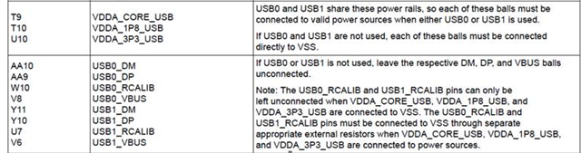

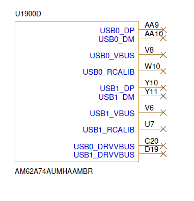

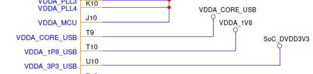

AM62A7-Q1: Does connecting the USB supply rails (refer Pin connectivity requirements) while the USB signals including RCALIB are NC affect system boot or functionality?
Part Number: AM62A7-Q1
We didn’t use the USB module but still connect the VDDA_CORE_USB/VDDA_1P8_USB/VDDA_3P3_USB to the power, and the USB related pin keep unconnected in the design.  Due to our PCB Gerber has been released to the factory, we can’t change the net connection now, what will happen for the design? Can the system start normally in this situation?We can only disconnect the VDDA_CORE_USB through update the BOM.
