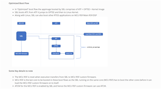

We are currently debugging TDA4VH's SBL boot, use optimized mode to boot HLOS.
However, it was found that the generated combined_opt.appimage was larger than 22MB because it contained a linux kernel image.
And, the boot partition of our EMMC is 8MB
So we have two questions
1.If we want  use optimized SBL mode, we first need to enlarge the boot partition to 32MB
2.What does the Optimized sbl boot image layout in j784s4, look like J721E in the image below
