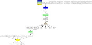

I am working on a pipeline for a segmentation model with ti-processor-sdk-rtos-j721e-evm-07_01_00_11.
My Final pipeline
Capture - > Custom Color Conversion ( YUYV to NV12) -> Scalar -> TIDL -> Post-proc -> Mosaic -> Display
My Current Development Pipeline
Graph for your reference
I have verified my capture and color conversion output after dumping them and it is correct.
When I dump the Scalar output it is completely Green as shown below:
I am using scalar source code from the app_tidl_cam application.
Could you please let me know the possible reason for the same, where I am going wrong?
I need two outputs from the scalar node one for preprocessing and another for postprocessing for segmentation.
One Experiment:
Just to confirm if the custom kernel buffer was properly mapped, I changed the pipeline
Capture->Color Conversion-> Pre-processing
I commented the scalar node and provided the pre-processing node with the direct output of the color conversion.
As pre-processing size expectation is 768x384 and the output from the color conversion node is camera resolution 1280 x 944 so it has cropped the image for converting it from NV12 to RGB Planar.
So this confirms that the color conversion kernel output buffer is properly mapped.
