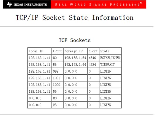

    Thanks for your help, I have the other one question.
    i'm using NDK client example   that from mcsdk_2_00_01_12  run on EVM6670L.
       I have modified  client.c and used TCP mode
    char *LocalIPAddr = "192.168.1.41";
    hEcho = DaemonNew( SOCK_STREAMNC,inet_addr(LocalIPAddr), 56, dtask_tcp_echo,
                           OS_TASKPRINORM, OS_TASKSTKNORM, 0, 3 );
    I use a PC client  programe  connect NDK which is running on DSP ,but a few  second  socket connect will fail.
    [C66xx_0] QMSS successfully initialized
    [C66xx_0] CPPI successfully initialized
    [C66xx_0] PA successfully initialized
    [C66xx_0]
    [C66xx_0] TCP/IP Stack Example Client
    [C66xx_0] PASS successfully initialized
    [C66xx_0] Ethernet subsystem successfully initialized
    [C66xx_0] Ethernet eventId : 48 and vectId (Interrupt) : 7
    [C66xx_0] Registration of the EMAC Successful, waiting for link up ..
    [C66xx_0] Network Added: If-1:192.168.1.41
    [C66xx_0] Service Status: Telnet   : Enabled  :          : 000
    [C66xx_0] Service Status: HTTP     : Enabled  :          : 000
    [C66xx_0] 00421.600 TCP: Retransmit Timeout
    [C66xx_0] 00431.600 TCP: Retransmit Timeout
    [C66xx_0] 00438.500 TCP: Retransmit Timeout
    [C66xx_0] 03917.400 TCP: Retransmit Timeout
    [C66xx_0] 05525.100 TCP: Retransmit Timeout
    [C66xx_0] 05537.400 TCP: Retransmit Timeout
