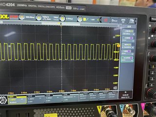

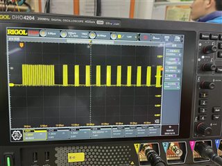

  • I found out there was an error reading the magic number
    ti-processor-sdk-linux-j721s2-evm-08_06_01_02/board-support/u-boot-2021.01+gitAUTOINC+62a9e51344-g62a9e51344/common/spl/spl_spi.c
    spl_spi_load_image ->
                                      else if (IS_ENABLED(CONFIG_SPL_LOAD_FIT) &&
                                              image_get_magic(header) == FDT_MAGIC) {
  • There were no mistakes when I was flashing,because I made the following modifications and it was successful
    spi-tx-bus-width = <8>; -->  spi-tx-bus-width = <1>;
    spi-rx-bus-width = <8>; --> spi-rx-bus-width = <1>;

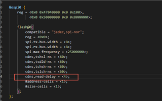

  • "Can you please try xSPI?"
    I have tried, but there are still issues.
    What is ”cdns,read-delay “ used for configuration? I changed it to 1 and board can boot normally,configure SOC read data delay?
    How to configure this parameter in PDK? Because I also encountered a problem when boot using SBL method
    That is good. So SPL is working. I will loop in our SBL expert for this.

  • clock:
    4MHz、33MHz
  • The signal indicate 4M is in BOOT ROM Stage, later change to 33M is in SDR mode. if PHY enabled. Anyway ,the PHY parameter  Reg_0x47040018  isn't correct. Accoridng the ospi_sbl code, the clock should be 200MHz with PHY enable in the funciton SBL_ReadSysfwImage(). Please check.
