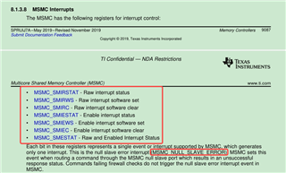

  • I want to know why I cannot write to the registers 0x6E000000 to 0x6E00A018 on the core MCU3_0 and can only write to the core C7x. Is this related to the following figure?
    Can I write this register on the core MCU3_0? What settings need to be modified?
    The above register space is firewalled. Are you seeing a firewall exception while accessing that from MCU3_0?
    - Keerthy
      I have indeed seen firewall errors in the Log. Can I not operate on these registers?
  • No. The TIFS firmware restricts these register access. The MCU3_0 will not be able to configure these registers.

        1.Is the null slave event error in MSMC enabled by default or I need to modify the WS register in the following image to enable this function?
        2.Is the NULL Slave in the following figure the same as the appeal content?

    MSMC implements a null slave endpoint to handle accesses which cannot be sent to their intended destination
    My understanding is that NULL slave reporting is enabled by default.
    The two TRM sections shown above are both referring to the Null Slave handling in the MSMC.

      I have two more questions to confirm now:
      1. Is the activation of MSMC NULL Slave function controlled through the following registers?
      2. Will be NULL_ Setting SLV Bit to 1 means it is enabled, right? The default value I am currently reading is 0.
    In testing on target, contrary, to response above the MSMC NULL error reporting is disabled by default.
    Regarding the MSMC_SMIEWS Bit[0], checking with internal team on this.   NULL_SLV Bit[0] is a 'W' only bit, its read back value will not have any meaning.
    The MSMC_SMIESTAT Bit[0], should reflect the current state of the enable.

    When I obtain the status, it is the MSMC that I read_ SMIESTAT register. Actually, in the chip manual, MSMC_ SMIESTAT and MSMC_SMIEWS the register addresses are the same.The value I obtained when reading MSMC_SMIESTAT [0] is 0, so I believe this feature is not enabled.
    How should I enable this feature?

    Some updates on the NULL Slave Error
    • The detection of a NULL Slave Error is always enabled by H/W, no S/W interaction is required.
      • How the error is handled on the originating core, is a function of that core.  For example the A72 QNX would likely generate a SIGBUS.
      • I have not tested the Null reporting before, but expectation is that if a valid address range in the device memory map is accessed, where the memory being accessed does not have a corresponding H/W module, the Null reporting module would be hit.
    • The logging/reporting of the Null slave error as you have noted is required to be enabled by S/W
      • The Null Slave Error reporting is not enabled by default in the TI SDKs
      • There in an internal discussion on TI side on enablement of this feature.
