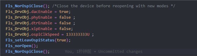

We are attempting to unmount the Nor flash device using the FLS driver under MCAL, in order to mount it properly on the SOC side. We followed the approach of the 'OSPILeaveConfigSPI()' function in the PDK to set the OSPI to the legacy SPI mode, but we are encountering errors. Could you please advise on how to configure it correctly for unmounting this device?
Here are the changes we made:

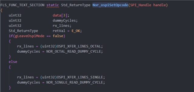

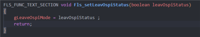

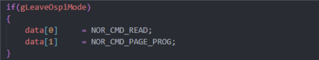

And we found that the error reported were in the following area,
