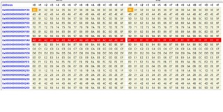

I want to make a BOOTLOADER for TMS570LS0714APZ. If I use the same program but different ICs, I will find that some can be programmed successfully, but some will fail. The following is the situation I tested.
1. Although adjusting SYS_CLK_FREQ can solve the problem of unsuccessful programming of different ICs, SYS_CLK_FREQ is fixed and cannot be adjusted for each IC during mass production, so this method cannot be used.
2. After the burning failed, read the burning content and found that there is a phenomenon, that is, the value of 16 BYTE is 0xFF every time, that is, the writing is not successful. It seems that the problem is Fapi_BlockProgram, in red font The two judgment conditions were added by me. They are improved but errors still occur.

PS:When reading the FLASH content when an error occurs, 16 consecutive BYTEs will be sent, but none of them are written.

  • Hello:
    What is more incomprehensible about the current situation is that if it cannot be programmed or a programming error occurs, I only need to change the SYS_CLK_FREQ frequency setting in the bl_config.h file (at 32MHz~64MHz) and the other programs will not change. After assembling the program, you can successfully execute the BOOTLOADER function and burn the program into the MCU.
