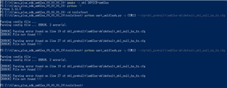

I met the problem below  when flashed the SOC initialization binary to the EVM.
Despite I make steps as the instruction of TI website below, the issue does always appear.
Please help to find the reason & resolve it ,thanks!
  • My EVM is set up to UART BOOT mode. If I execute the command as the instruction below in windows env., it failed as above Pic. shown:

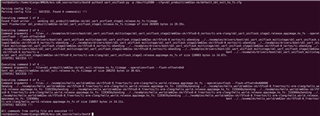

    But it works on the Ubuntu env as below:
  • I've made several tests in UART BOOT mode. Sometimes, the errors still happen in the Ubuntu env below:
    It seems to be stuck for three minutes in the third stage when flashing in progress. This happens frequently in our board when debuging. I stll adopted the MCU SDK8.06.
    From the image shared above it shows that the uart_uniflash tool is not able to find the files specified in default_sbl_null_hs_fs.cfg file.
    Please build the sbl_uart_uniflash_stage2 image and hello_world example by using the below commands.
    Please run the below command from MCU+SDK root directory.
    For sbl_uart_uniflash_stage_2 image :
    gmake -s -C examples/drivers/boot/sbl_uart_uniflash_multistage/sbl_uart_uniflash_stage2/am62ax-sk/r5fss0-0_nortos/ti-arm-clang
    For hello_world appimage:
    gmake -s -C examples/hello_world/am62ax-sk/r5fss0-0_freertos/ti-arm-clang/hello_world.release.appimage.hs_fs
    After building the above required images, please re-try to initialize the board. For more info, please refer EVM_FLASH_SOC_INIT.
