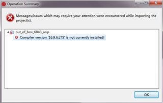

Actually this may be an issue with project imports in Resource Explorer. Can you try importing directly like mentioned in the thread below:
ki

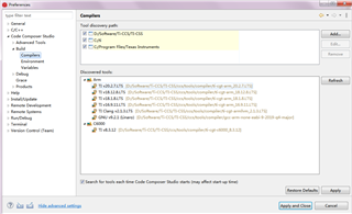

Gary - in your case, you don't have that specific compiler installed.
You can download from:
https://www.ti.com/tool/download/ARM-CGT/16.9.6.LTS
Then follow the steps below under "Compiler Discovery" to have CCS "discover" it:
https://dev.ti.com/tirex/explore/node?node=A__AJRfIGmBSkp9naUDysxAFg__ccs_devtools__FUz-xrs__LATEST
