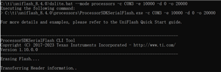

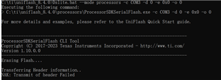

Command:(Try to erase flash)
Dslite.bat --mode processors -c COM3 -d 0 -e 0x1000 -o 0
Result: (Error: Transmit of header failed or stuck at transferring header files)

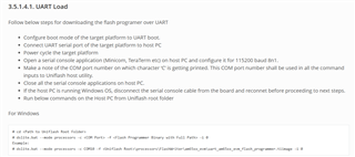

    Were you able to download the flash programmer according to software-dl.ti.com/.../index_board.html
  • Hello Jianzhong,
    Thanks for reply, I can load the flash programmer successfully through JTAG lane. By using the following command:
    dslite.bat --mode load --config=C:\Users\a1771\workspace_v9\DMTimer_test_1ms_modified_CAN\DMTimer.ccxml -f C:\ti\uniflash_8.4.0\processors\FlashWriter\idkAM437x\uart_idkAM437x_flash_programmer.out -n 1

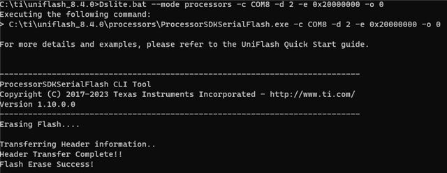

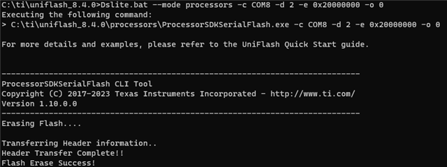

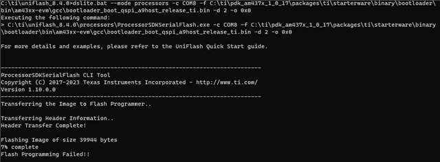

    Then I try to erase flash,
    Command:
    Dslite.bat --mode processors -c COM8 -d 2 -e 0x20000000 -o 0
    Result:

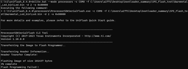

    Finally, I tried to transfer the image. However, it showed flash program failed.
    Command:
    dslite.bat --mode processors -c COM8 -f C:\Users\a1771\Desktop\bootloader_summary\SPI_Flash_test\Baremetal_Led_bin\Led_ti.bin -d 2 -o 0x80000
    Result:
    Best Wishes,
    Yuzhi
  • Hi Yuzhi,
    Your Led_ti.bin might have some problem. Please take a look at this FAQ as a reference. That FAQ was written for AM335x, but the principle applies to AM437x as well.
    Jianzhong
  • Hi Jianzhong,
    Thanks for your reply.
    If I rename Led_ti.bin to app I can transfer the image into spi-flash and boot from spi-flash.  I also tried to transfer other examples provided by TI, however I cannot transfer the images by Uniflash to flash as well.
    I cannot flash the boot image as well.
    Here is the code I use:
    dslite.bat --mode processors -c COM8 -f C:\ti\pdk_am437x_1_0_17\packages\ti\starterware\binary\bootloader\bin\am43xx-evm\gcc\bootloader_boot_qspi_a9host_release_ti.bin -d 2 -o 0x0
    Following are commands and files I used to flash spi-flash. I have attached files.
    • Command: load flash programmer.
    File used: DMTimer.ccxml, uart_idkAM437x_flash_programmer.out
    • Command: transfer boot image.
    File used: bootloader_boot_qspi_a9host_release_ti.bin,
    • Command: transfer led image.
    File used: Led_ti.bin
    spi-flash_document.rar
    Best wishes,
    Yuzhi
  • Hello Yuzhi,
    Since TI has stopped supporting PDK (bare-metal or TI-RTOS) based SW development for AM437x, I'm not able to provide further help here. Please refer to this announcement and find resources there.
    Jianzhong
