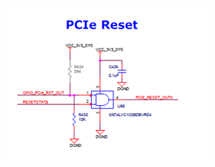

    Could you review the reset implementation as below
    The PCIe reset remains asserted till the SoC GPIO releases the reset.
    Sreenivasa
  • Hi,Sreenivasa
    I do not know what this confirmation means.

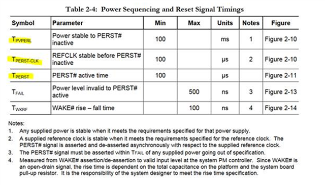

    If you are concerned about the timing between the reset release and the clock, we have heard the following from our customers.
    "Since it follows the PCIe standard, the clock should be output at least 100us before the reset release. Our board is clocked 226us before the reset release, so it meets the standard."
    Also,
    The PCIe reset (PERST_N) is controlled by GPIOs as on the evaluation board, and the timing waveform image from the start of PCIe clock (REFCLK0) output to reset release is attached (REFCLK0_to_PERST_N.png). From clock output to reset release, there is 214.88us in the attached figure, which is more than 100us, so it meets PCIe standard."
    Let me know if you need confirmation for some other intention.

  • Hello Kouji Nishigata
    Thank you for the inputs and my question was around the reset timing.
    Would it be possible for customer to increase the time by another 50-100 us and do a check.
    Thios is based on the input that the issue is observed during power-up and not happening always.

  • Hi,Sreenivasa
    We received three diagrams from the customer.
    The 1st one is when the REFCLK0 - PERST_N delay is extended to 616us. In this case, the phenomenon (undetected PCIe device) still occurs.
    The 2nd picture shows the timing waveform of PCIe Power 3.3V - PERST_N. The delay time is long enough to meet the PCIe standard of 100ms or more.
    The 3rd waveform is the waveform of REFCLK0 - PERST_N when PCIe device non-detection occurs. However, the Reset time is 200us because it was before the delay time was extended.

  • Hi, Sreenivasa
    > Could you please confirm the required filters, bulk caps and decaps are provided for the serdes0 supplies on the customer board.
    The serdes0 and CPU power supplies on their board are basically the same circuit and components as the 64GPEVM.
    And they have added the necessary filters to the VDDA_0P85_SERDES0 and VDDA_1P8_SERDES0 power pins.
    I attach a schematic of the surrounding area just in case.

  • Hi, Sreenivasa
    Thanks for the responce.
    Does this mean that the REFCLK0 - PERST_N delay is extended beyond 100msec?
    For "PCIe Power 3.3V - PERST_N" the town has already included more than 100msec.
    The phenomenon still occurs.

  • Hi, Sreenivasa
    I am looking at the patch you gave us and it reads PCIe Power 3.3V - PERST_N delay to 100msec or more.
    This was already implemented by the customer.
    There does not seem to be any specific mention of the REFCLK0 - PERST_N delay, but I assume you mean to make this more than 100msec? Since it is now 200 -> 600usec, should I ask the customer to make this change?

  • Hi, Sreenivasa
    The customer had the REFCLK0 - PERST_N delay changed to 105.4 ms, but the situation has not changed and does not appear to have changed in terms of playback frequency.
    What concerns me about this issue is the i2236 errata. The current silicon revision has been addressed, but the EVM is externally powered. Is there an example of using the SERDES reference clock as a PCIe reference clock as our customer does?
