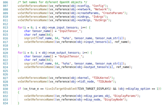

Everything in the first dynamic library which contains the fisrt TIDL-Node runs well, graph successfully created and verified, objects successfully detected out; but the graph of the second TIDL-Node cannot be successfully verified. I am just wondering if I can implement 2 TIDL-Nodes in one process? or the reference name set by vxSetReferenceName() should not be the same?
the tivxTIDLNode set as shown in the following pic:
tivxTIDLNode set as shown in this pic
other properties set by vxSetReferenceName() as shown in the following pic:
other properties settings

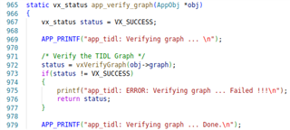

the program stopped when verifying the graph of the second TIDL-Node at line 972 in the following pic:
program stopped at line 972

    Could you please share the error log you are facing?
    Please enable the remote core logs first (i.e. ./vision_apps_init.sh) before running the application, to get the logs from the remote cores.
    Please share the same to get a better understanding of the issue.

    I have located the bug. You can see in the pic bellow:
    appInit
    I added this function appInit() in the function app_tidl_main() before app_init().
    When these 3 functions (appCommonInit(), tivxInit(), tivxHostInit()) run for the first time, everything goes well, and when the second dynamic library started to run, the return value of appCommonInit() will not be 0. So I think it is illegal to operate appCommonInit() twice in one process, right?
    Or, can someone tell me, what have these 3 functions (appCommonInit(), tivxInit(), tivxHostInit()) done in the A72 and C7x core?
    This should be called only once.
    In the latest SDK, I see that there is a flag set for this to ensure this is called only once.
    These functions are only called for A72.
