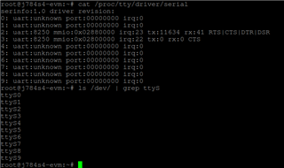

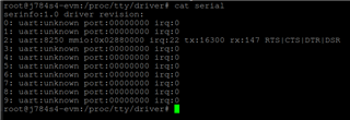

    With these changes, I get the below results.
    Before UART0 initialization and alias addition:
    And after UART0 initialization and alias addition:
    And logs that also indicate ttyS3 is UART0 (aka, main_uart0: serial@0x280000 = ttyS3).

    However, for the UART issue I think I have located the issue. It seems like with 9.x SDK we removed a kernel config that specifies max UART instances, and a default value of 4 is pulled from somewhere.
    Adding this back to defconfig, rebuilding the kernel, and reflashing makes more serial instances appear in terminal:
    https://e2e.ti.com/cfs-file/__key/communityserver-discussions-components-files/791/0001_2D00_Re_2D00_add_2D00_max_2D00_UART_2D00_instances_2D00_to_2D00_10._2D00_Increasing_2D00_from_2D00_def.patch
    Since only 4 instances of serial is available without these configuration, it looks like the UART instances were assigned to any available serial instance, which causes main_uart4 to enumerate as ttyS0. In 8.6 SDK, we had set this to 10 instance, so this is an issue only seen with 9.0 - which I have reported to our SDK team about.
