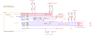

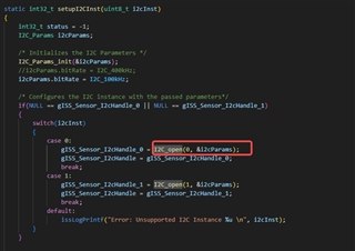

TDA4AL-Q1: camera app got stuck while opening I2C0
Part Number: TDA4AL-Q1
Hi TI,
       camera  app got stuck while opening I2C0  in sbl mode
     log:

  • Hi  Brijesh,
      our camera use  i2c hardware:
    and must disable main_i2c0 ?
    &main_i2c0 {
     status = "disabled";
  • Yes, if you are using i2c0 from R5F, then it must be disabled from A72.

  • Dear Brijesh,
          it is already disabled, but  it is hanging in  I2C_open
  • ok, then is it powered on? Maybe since it is disabled on Linux, noone is powering it on and so it is causing crash in i2c_open, which might be trying to access this register.
    Can you please try powering it on, using below, before calling i2c_open?
    SET_DEVICE_STATE_ON(TISCI_DEV_I2C0);
    Brijesh

  • i2c0 work ok in MCU2_0 when  disable i2c0 in A72.  But  TDA4 can not recevie any image when sensor stream on:

      1. SPL boot,   camera  was working fine
      2. Add SBL patch,  camera  stuck in i2c open,  and disable i2c0 dtsi in A72, then I2C working fine, but TDA4  capture node does not receive image.
         SBL patch:6607.sbl_patch.rar
