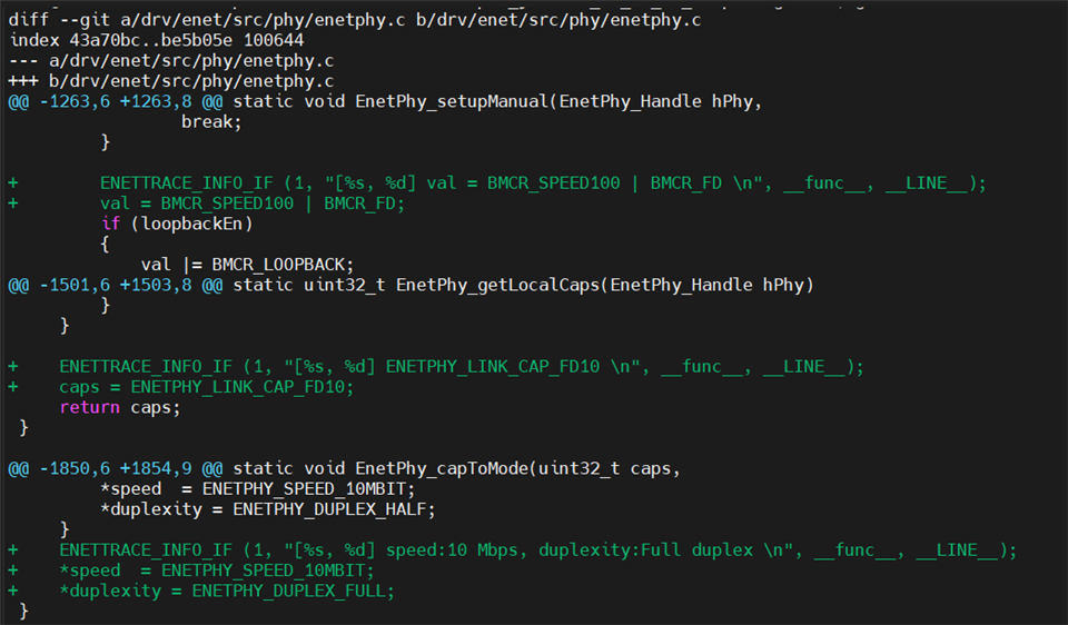

Hi TI Experts,
Customer is working on TDA4VM SDK8.6.
They are using the RGMII in both Main & MCU domain for the CPSW.
They have tested that for the fix speed @ 100Mbps is working normally.
However, when they try using fix speed @ 10Mbps, the link is up but the ping is not working.
May I know if there is any known issue of RGMII @ 10Mbps in the TDA4VM SDK8.6?
