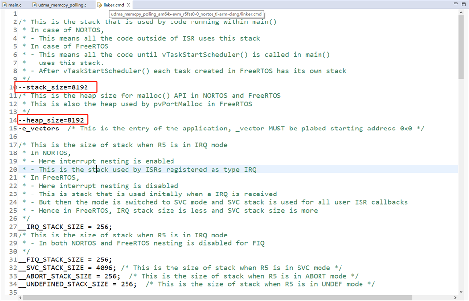

Customer wants to run the udma_memcpy_polling example from TCM memory, so he modified the .cmd file, changed the .bss section from MSRAM to R5F_TCMB0 or R5F_TCMA. But the code can't run successfully.

    Customer only modified the --stack_size and --heap_size, please see below snapshots.
    Shine

    Thank you for providing the exact changes. I could now build the example & see that it is indeed failing with the same logs as the logs shared by the customer.
    On experimenting, I can say that the failure only comes on allocating `.bss` section to TCM memory. If I allocate `.sysmem` & `.stack` to TCM while keeping `.bss` to MSRAM like below the application runs successfully.
