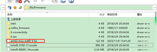

1 I am adapting the latest m-core software development package with the a-core linux version 09.0000.03 and the m-core version 09_00_00_19
2 I am testing the ipc_rpmsg_echo_linux _ m4fss0-0_freertos example。 I compiled the m-core program with ccs, put am62-mcu-m4f0_0-fw under the / lib / firmware directory and boot to load up automatically。It works just fine
3 I compiled the a-core program ti-rpmsg-char and put it under / home / root to run the error
4 I use the TI official development board on my hardware, and A core and m core do not made any changes. Why does this phenomenon occur?

  • 1 I found the reason, the ti-rpmsg-char I use is not the latest version, after the replacement, the test is normal.
    2 I found a new phenomenon, the r5f core will send 100,000 data to the m core by default, which takes more than ten minutes. I noticed that is tispl.bin contains ipc_echo_testb_mcu1_0_release_strip.xer5f with ipc function。
    3 I don t know that ipc_echo_testb_mcu1_0_release_strip.xer5f is compiled from that source file and I want to modify this file to reduce the number of people who send it from 100000 to 1 so how do I need to do it ?
