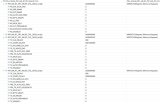

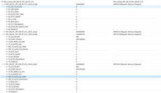

I am trying to test the "Ethercat Slave Simple Demo" on one of our custom boards.
I have already tested the example on the AM64x EVM. Here the Ethercat Slave is recognized correctly. For Testing I use EC Engineer. The SDK I use is "ind_comms_sdk_am64x_09_00_00_03"
The setup of our custom board differs as follows:
  • I use the DP83848IVV/NOPB twice as phy and have configured these according to the Ethercat specifications. Both phys are recognized correctly.
  • I use the ICSSG0 instead of the ICSSG1 and set the correct pin config in the sysconfig.
  • MII0_RXLINK has a different polarity for the Phy. The polarity was adjusted as follows:
    #define ECAT_PHYPOLINVERT_IN (false)
    #define ECAT_PHYPOLINVERT_OUT (false)
I have ensured that the Ethercat data arrives correctly at the MII interface of the AM64:
MII_RXD0:3 -> Data measured
MII_RXCLK -> Clock correct
MII_RXER -> no errors
MII_RXDV -> Data valid
MII_TXCLK -> Clock correct
By initializing the example I get the following output which also looks correct:

The problem is that the MCU does not send any response to the Request via MII_TXD0:3 and MII_TXEN is also not active. Can you tell me where my configuration could be faulty and what steps I can take for further diagnosis?
Many thanks in advance.
